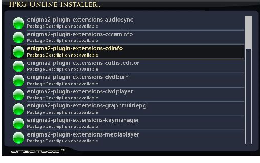

    • Strange differfent
      Thanks but this is strange. _By my knoledge I have the latest version.
      I see a different installer. It is the skin diferent but not see any plugin that not installed.
      What can be wrong here? This list no VLC. I can page down and also not.
      Search for setting but not find nothing.
      Thanks,
      doki_2

    • RE: Strange differfent
      Download the plugin from stable feet and install it manual. Copy the file "enigma2-plugin-extensions-vlcplayer experimental-git20110122-r0DM8000.ipk" in temp and flash it offline from Internal Flash.
      Alternativ you can download the vlcplayer from unstable feet from 09 Febr.2011 !
      Hi All,
      Thaks for all including for the new immage.
      This a topic closing. I installed the new image(Newnigma2 v3.1.5) I meant to flash it as new but tried the online update what did not work. As he wrote me no new update.
      Everything work fine. All the plugins I can see now.
      doki2
