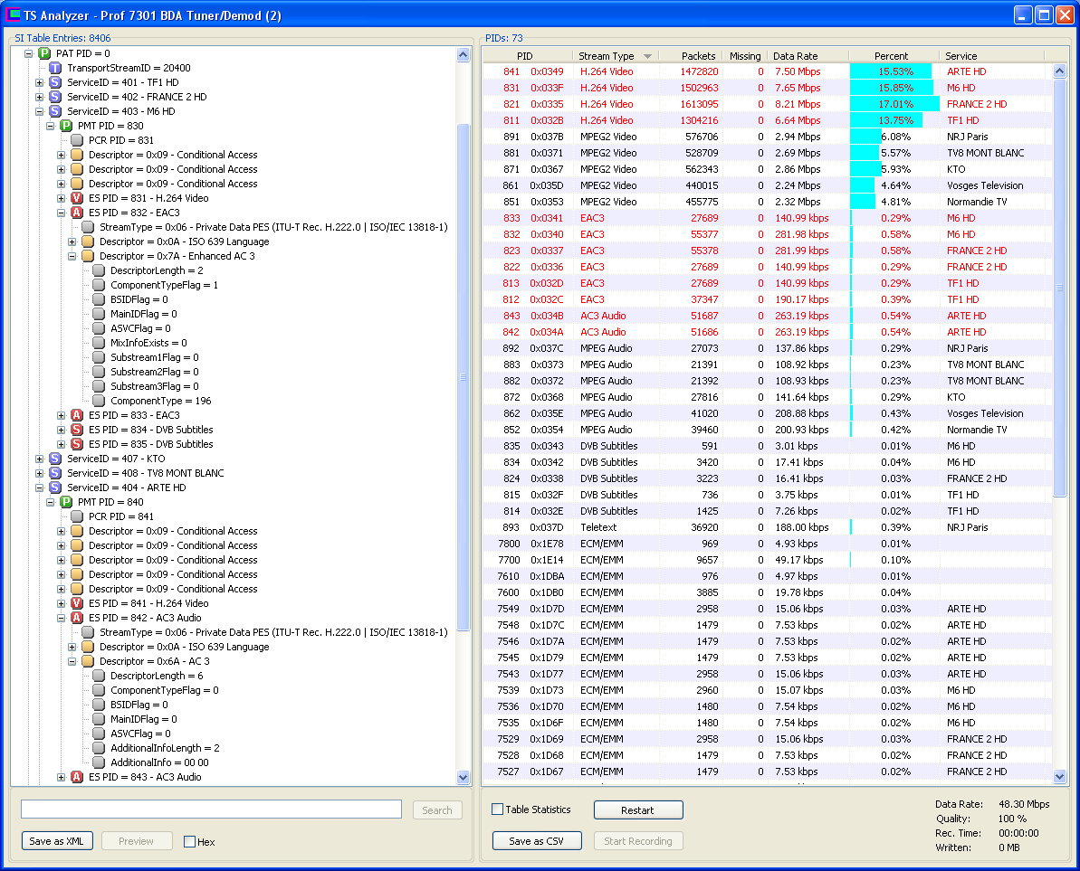

      Hi,
      work audio on HD channel`s from 5 West ?
      I am use:
      DM-500HD
      2011-04-26-experimental
      Newnigma2 v3.2.1 2011-05-04
      In SD show audio track, but in HD without audio track :(
