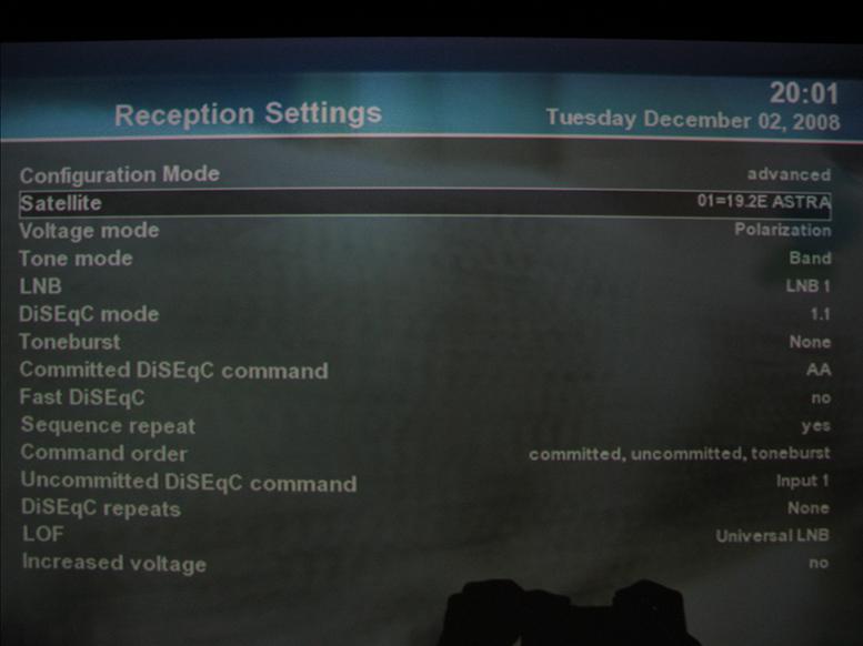

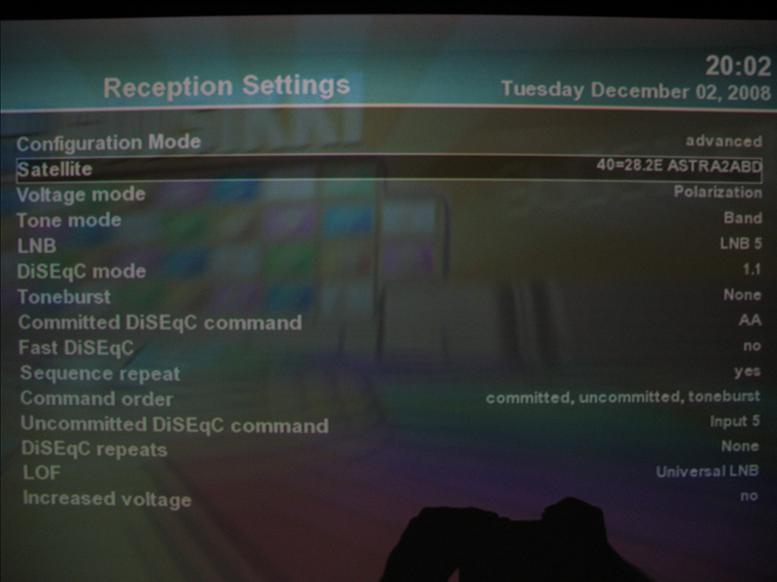

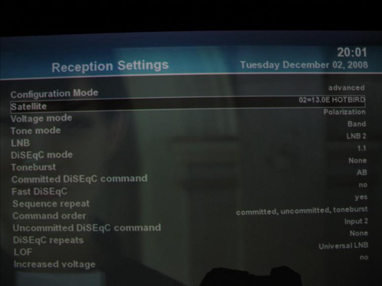

      I fought long & hard to find working diseqc settings for my Dreambox 800 & 8 satellites, here is how i configured them:
      19E lnb1 input1
      13E lnb2 input2 (or input1, depending on the diseqc model)
      5E lnb3 input3 (or input1)
      1w lnb4 input4 (or input1)
      28E lnb5 input5 (ori input2)
      23.5E lnb6 input6 (or input2)
      16E lnb7 input7 (or input2)
      9E lnb8 input8 (or input2)
        38,25 kB, 777×582, 5.120 mal angesehen
        35,45 kB, 777×582, 4.316 mal angesehen
        38,63 kB, 777×582, 3.610 mal angesehen
    • RE: Working diseqc settings 8-1 for 800/7025 here
      u probably mistakenly put 28.2e (the last picture) lnb5 uncommmitted input 5 , that cant be right
      heres a setup on my 7025+ using 1 (2/1) uncommitted + 2 (4/1) normal diseqc
      i have left lnb8 out and thats why lnb7 is at input2_BB
      !!!! Seems i made a mistake on the pictures , secuense repeat should be on and the secuence should be uncommitted,committed,toneburst !!!!!

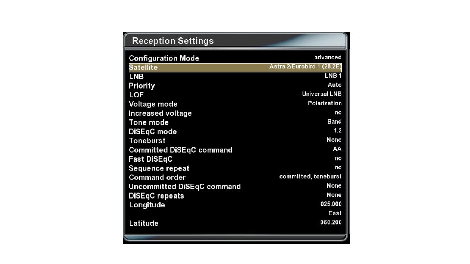

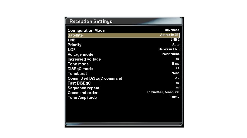

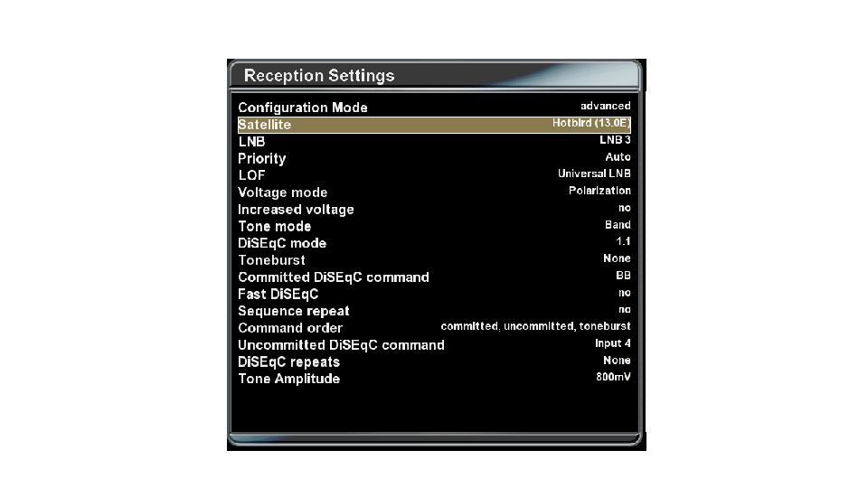

    • RE: Working diseqc settings 8-1 for Enigma2 here
      I'm gonna also add here my configuration, if it helps someone. How ever, this is not 8 satelite, but 5+motor by using two 4/1 switch.
      Cable goes to motor first, then 1/4 committed switch and from BB connection to uncommitted 1/4 switch.
      There is two dish in this configuration, one has motor and other has 5 LNB's on multifocus.
      Base idea is that most popular satelites are behind those 5 LNB and switches.
      LNB1 how ever is connected motor and every other wanted satelite use LNB1 and USALS.
      28.2E Committed AA (+ motor) (Picture 1) (LNB1)
      19.2E Committed AB (Picture 2) (LNB2)
      13.0E Committed BB + Uncommitted input 4 (Picture 3) (LNB3)
      9.0E Committed BB + Uncommited input 3 (LNB4)
      4.8E Committed BB + Uncommitted input 2 (LNB5)
      0.8W Committed BB + Uncommitted input 1 (LNB6)
      5.0W Committed AA (+ motor) (LNB1)
      (There is more motor based satelites same way than two showed here)
      Coordinate on first picture 60N / 25E on LNB1 is city of Helsinki in Finland.
