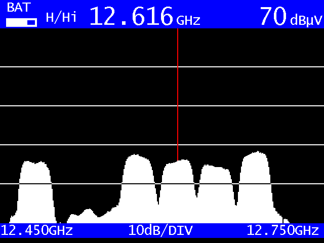

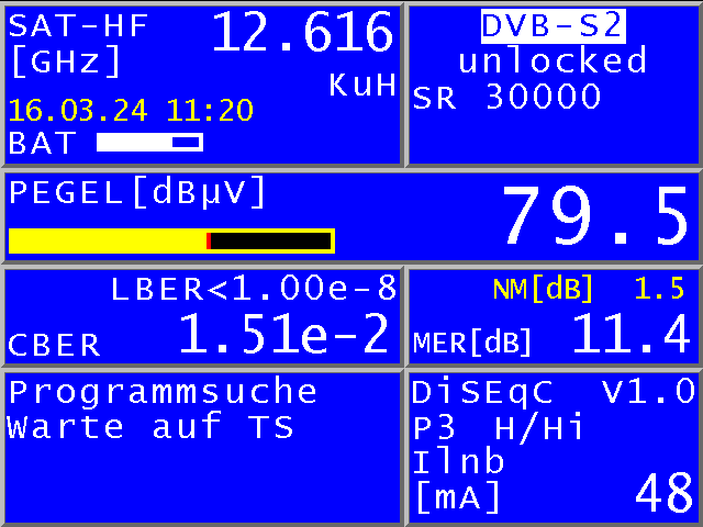

I am having a hard time in downloading Vivacom new channels on 13East Satellite.
When I try to Scan their Frequencies (12616H 8PSK 30000 5/6 - 12635 V 8PSK 30000 5/6, - 12654 H 8PSK 30000 5/6
AND 12673 V 8PSK 30000 5/6 I can see the signal but then the Receiver tells me ''Nothing to scan'' and
of course no channels are down loaded. I am using my Dreambox 920 UHD and also an Octagon SF8008
Also I have a complete channel list, (from a friend of mine) which include these Vivacom channels on Sat 13East
BUT when I try to open these particular channels I get the message of ''Service not found. SID not found in Pat.''
Any suggestions Please because I am lost why this is happening.
