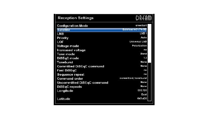

      I moved from a DB 7020 to a DB 800HD
      I managed to install the latest newnigma 2 image and to upload a channel list, have cccam working but ....
      I just cannot find the coorect way to store my different sat positions in the DB
      (this was quite different as menu on a 7020) and on this image I AM LOST
      I have a 1.2 m dish connected via a separate DisEQC 1.2 to the dreambox
      I select Positioner without Usals and go to the extended menus of Enigma2
      I manage with satfinder and with the remote of the positioner to "lock" a selected sat.
      But all different functions I tried could not result in the DB remembering the sat position and will not activate my positioner when i switch providers (sats)
      Could "an expert" please guide me through the correct procedure or point me to a link
      many thanks

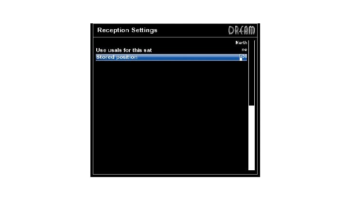

    • turn on your old 7020 and note all the different sats and the positions you have saved them.
      turn on db 800. go to tuner configuration---advanced. select the different sats(2nd row) und the position(last row).
      save
      and all sat should be working again.
