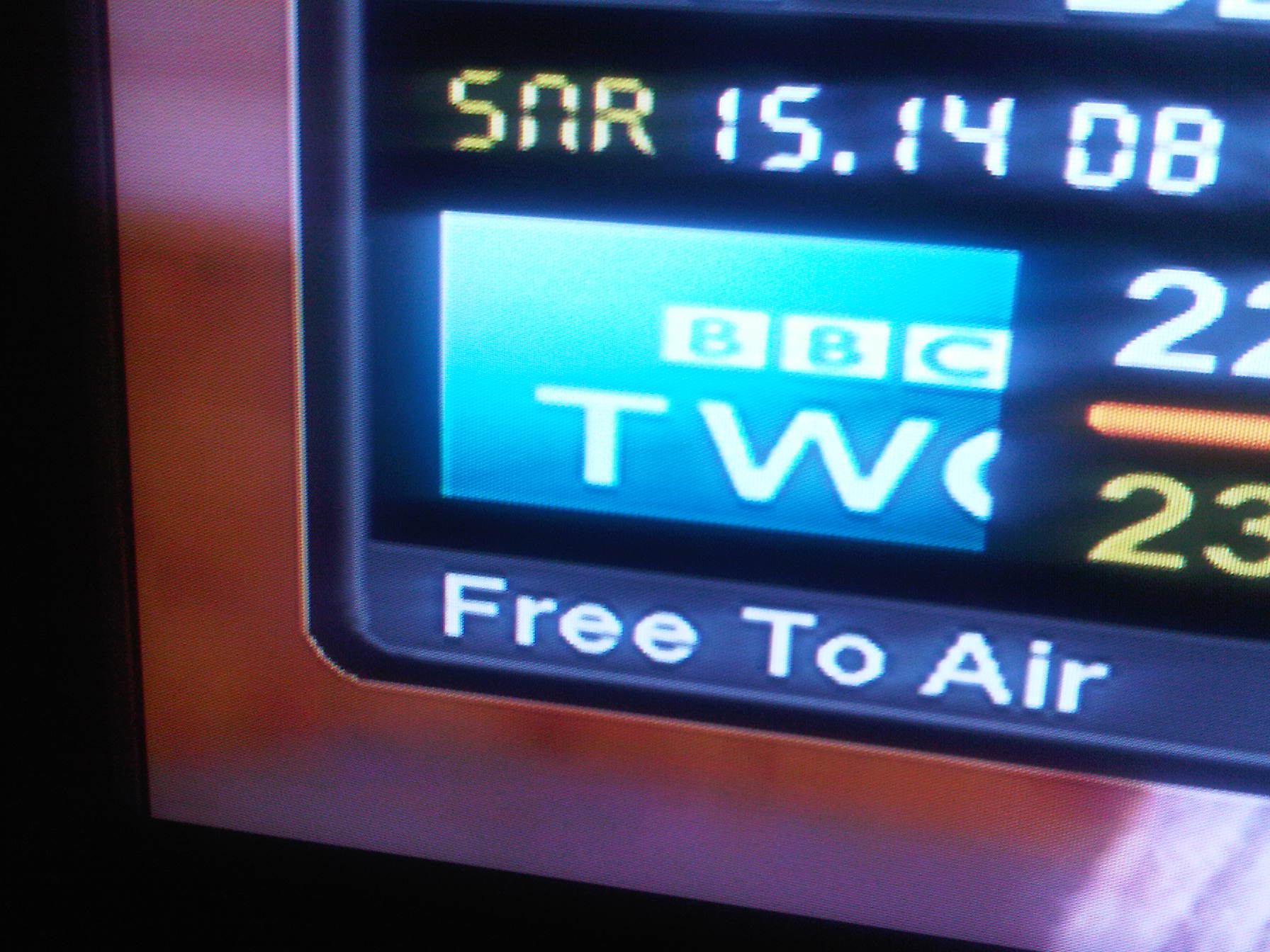

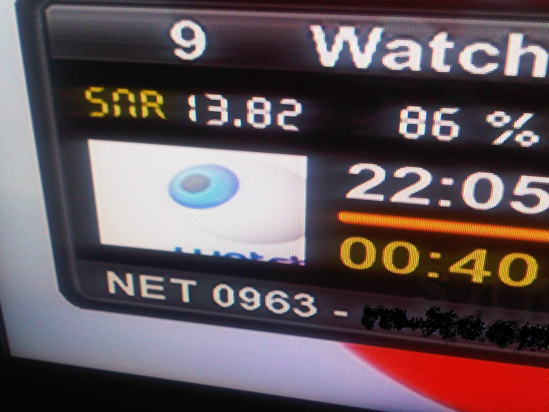

      i have opened FTP then opened picon folder then copy my picon file now the problem they showing but the picon are not full size
        269,6 kB, 1.792×1.344, 1.493 mal angesehen
        302,93 kB, 1.792×1.344, 1.462 mal angesehen
      Dieser Beitrag wurde bereits 1 mal editiert, zuletzt von GiftedOne ()
    • The picons you've downloaded are to big to fit to the infobar, you have to resize them to 100x60 Pixel for HD.
