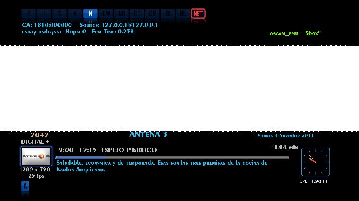

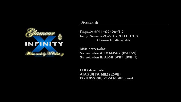

    • Have the same problem, updated to 3.3 yesterday and got a problem with the usb dvbt stick.
      When i install the driver packs in telnet for the stick, all channels stay black, only the FTA channels work.
      Although Cccam says it has successfully decoded them i keep a black screen. (this applys to the internal sat tuner and usb-dvbt stick)
      The drivers install correctly, and the dvbt usb stick is also recognized correctly.
      This has always worked with older newnigma2 versions, but with 3.3 it doesn't anymore.
      When i dont install the usb-dvbt drivers Cccam works correct and the channels work.
      (It is if something in the tuner selection settings if not working correctly.)

    • Hi, I have also the problems someone is experiencing. After installing nn2 3.3, I also installed the drivers for an Avermedia A867 (taken from SifTeam repositories) and extuner... The stick is recognized and works but even if cccam works encrypted channels are dark and .ts playback doesn't work anymore. If I unplug the stick and reboot all works (except dvb-t obviously :-)) . Anyone have some hints? Thank you!
