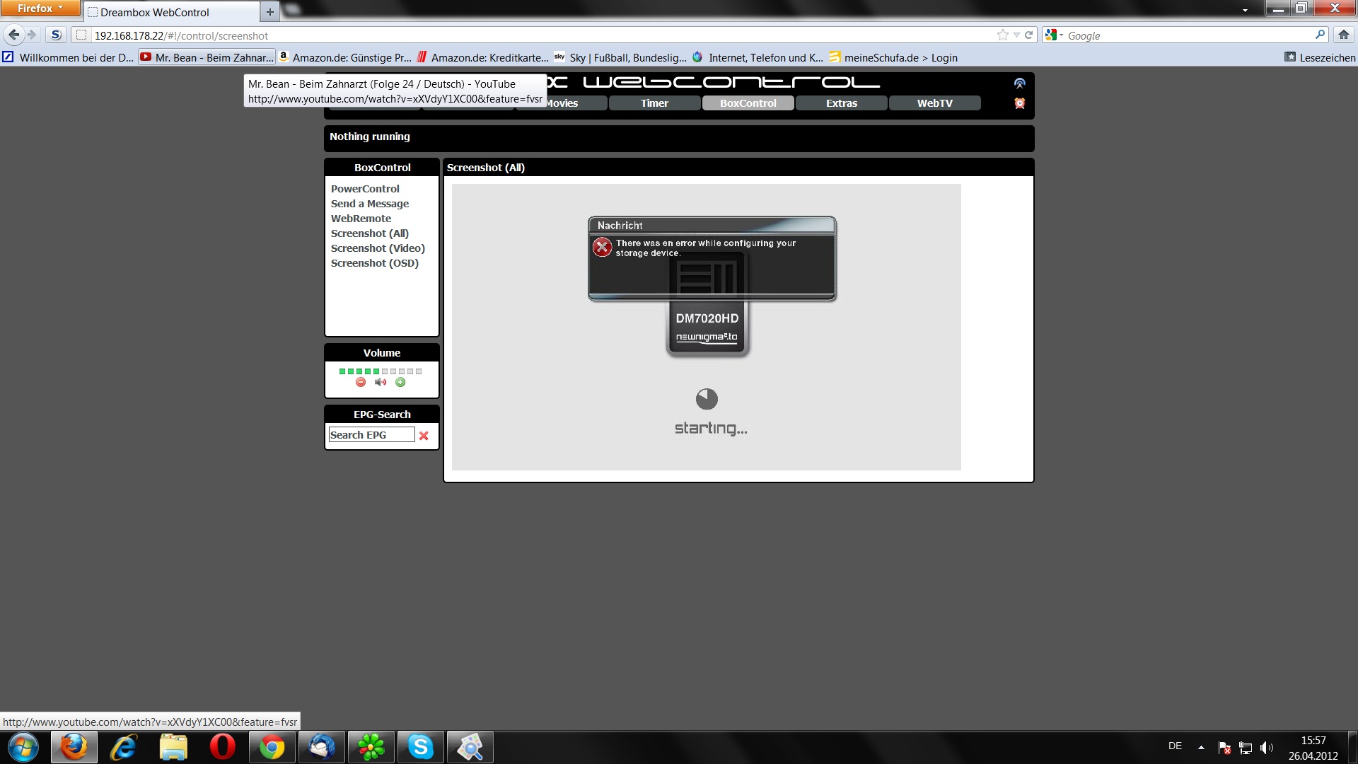

      versuche meine festplatte einzuhängen und ich bekomme immer diesen fehler "ther was en error while configuring your storage device"

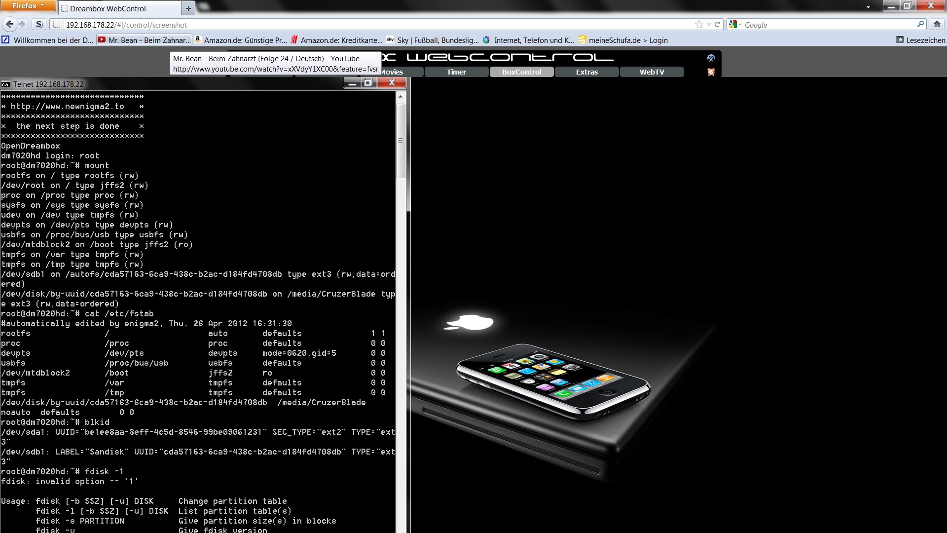

    • hier ist der log......Image ist newnigma3.3.2
      * newnigma2.to *
      * the next step is done *
      OpenDreambox
      dm7020hd login: root
      root@dm7020hd:~# mount
      rootfs on / type rootfs (rw)
      /dev/root on / type jffs2 (rw)
      proc on /proc type proc (rw)
      sysfs on /sys type sysfs (rw)
      udev on /dev type tmpfs (rw)
      devpts on /dev/pts type devpts (rw)
      usbfs on /proc/bus/usb type usbfs (rw)
      /dev/mtdblock2 on /boot type jffs2 (ro)
      tmpfs on /var type tmpfs (rw)
      tmpfs on /tmp type tmpfs (rw)
      /dev/sdb1 on /autofs/cda57163-6ca9-438c-b2ac-d184fd4708db type ext3 (rw,data=ord
      ered)
      /dev/disk/by-uuid/cda57163-6ca9-438c-b2ac-d184fd4708db on /media/CruzerBlade typ
      e ext3 (rw,data=ordered)
      root@dm7020hd:~# cat /etc/fstab
      #automatically edited by enigma2, Thu, 26 Apr 2012 16:31:30
      rootfs / auto defaults 1 1
      proc /proc proc defaults 0 0
      devpts /dev/pts devpts mode=0620,gid=5 0 0
      usbfs /proc/bus/usb usbfs defaults 0 0
      /dev/mtdblock2 /boot jffs2 ro 0 0
      tmpfs /var tmpfs defaults 0 0
      tmpfs /tmp tmpfs defaults 0 0
      /dev/disk/by-uuid/cda57163-6ca9-438c-b2ac-d184fd4708db /media/CruzerBlade
      noauto defaults 0 0
      root@dm7020hd:~# blkid
      /dev/sda1: UUID="be1ee8aa-8eff-4c5d-8546-99be09061231" SEC_TYPE="ext2" TYPE="ext
      3"
      /dev/sdb1: LABEL="Sandisk" UUID="cda57163-6ca9-438c-b2ac-d184fd4708db" TYPE="ext
      3"
      root@dm7020hd:~# fdisk -1
      fdisk: invalid option -- '1'
      Usage: fdisk [-b SSZ] [-u] DISK Change partition table
      fdisk -l [-b SSZ] [-u] DISK List partition table(s)
      fdisk -s PARTITION Give partition size(s) in blocks
      fdisk -v Give fdisk version
      Here DISK is something like /dev/hdb or /dev/sda
      and PARTITION is something like /dev/hda7
      -u: give Start and End in sector (instead of cylinder) units
      -b 2048: (for certain MO disks) use 2048-byte sectors
      root@dm7020hd:~#

    • root@dm7020hd:~# ls -la /media
      drwxr-xr-x 15 root root 0 Apr 26 16:31 .
      drwxr-xr-x 18 root root 0 Apr 26 16:17 ..
      drwxr-xr-x 7 root root 114688 Apr 25 01:08 CruzerBlade
      drwxr-xr-x 2 root root 0 Apr 26 16:25 WDCWD20EARS0
      drwxr-xr-x 2 root root 0 Jan 1 1970 card
      drwxr-xr-x 2 root root 0 Jan 1 1970 cf
      drwxr-xr-x 2 root root 0 Jan 1 1970 dev
      drwxr-xr-x 2 root root 0 Apr 26 16:18 hdd
      drwxr-xr-x 2 root root 0 Jan 1 1970 hdd-int
      drwxr-xr-x 2 root root 0 Jan 1 1970 mmc1
      drwxr-xr-x 2 root root 0 Jan 1 1970 net
      drwxr-xr-x 3 root root 0 Jan 1 1970 ram
      drwxr-xr-x 2 root root 0 Jan 1 1970 realroot
      drwxr-xr-x 2 root root 0 Jan 1 1970 union
      drwxr-xr-x 3 root root 0 Jan 1 1970 usb
      root@dm7020hd:~#
