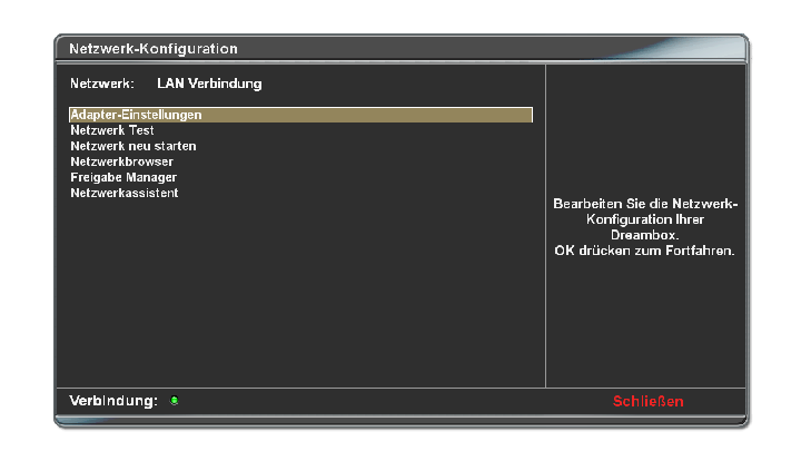

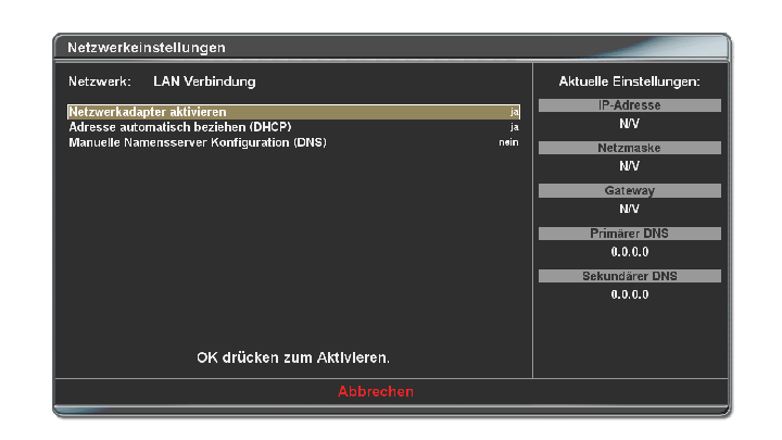

Well, needed these drivers and build them, so perhaps they can be useful to somebody else...
Seem to work nicely in NN2 oe1.6, but beware of fresh paint:)
How to/installation:
a) Copy the relevant ipk to STB
b) In telnet console: opkg --force-overwrite install rt5370*.ipk
c) Reboot
d) See attached notes
