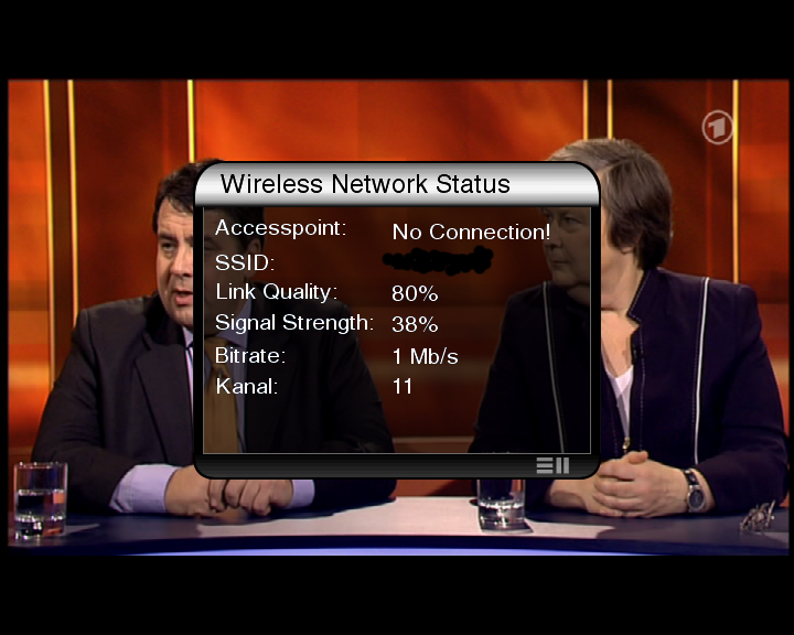

      Hi, I can´t help you, but you maybe can helping me ...
      I already tried everythink, but I can´t make my Wlan to work. :(
      I have DM800 and I tried many different images: Geminy 3.9-4.00, Newnigma2 2.2.3-2.3-2.3.1, Nabilosat E2 Black Hole - DM800 v0.7, LT Fifth SP5 DM800. I have a few USB Wlan Sticks: D-Link DWL-G122 ver:B1, FRITZ!Wlan usb Stick and A-QUIP 54M A/Wlan-1. But I don´t know how to make it work. Please any idea? ;(
      I don´t have any "Wireless network" options window... But I know it is can working...
      PS: In telnet commands "make" and "make install" does not work. Why?
        319,37 kB, 720×576, 1.228 mal angesehen
        316,96 kB, 720×576, 1.103 mal angesehen
      Dieser Beitrag wurde bereits 1 mal editiert, zuletzt von CrazyMiky ()

    • RE: wlan with newngma2 have to manual activate when i power back up help please
      Thank you for your answer...
      But my problem is:
      when I plug-in USB-Wlan Stick = nothing happen
      When I try dit a "Wizard network install" - there is still just "Internal ethernet" interface and no "Wireless interface".
      I already tried make a change some config files but without effect.
      My TV and DreamBox is in different room as my Wireless router. I have to make it work ... ;(
