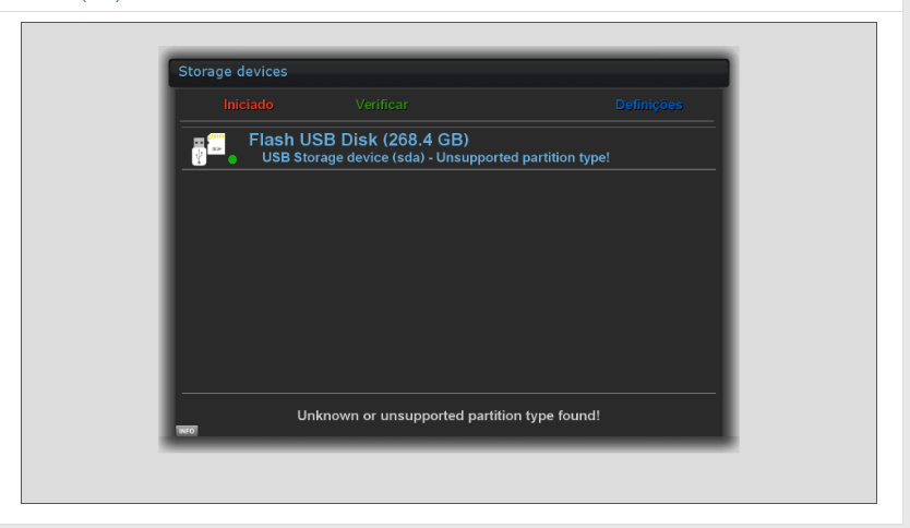

[gelöst] DM900UHD 4K - PAKETMANAGER (ERROR)

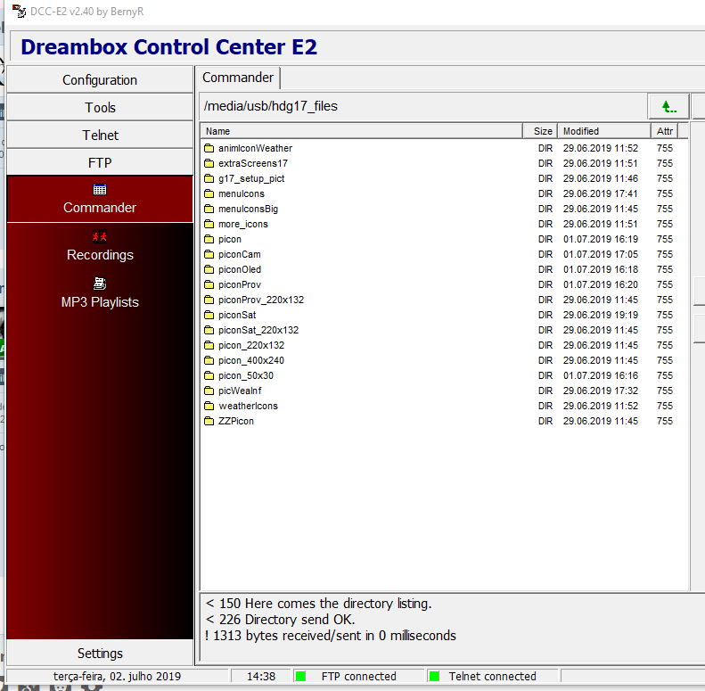

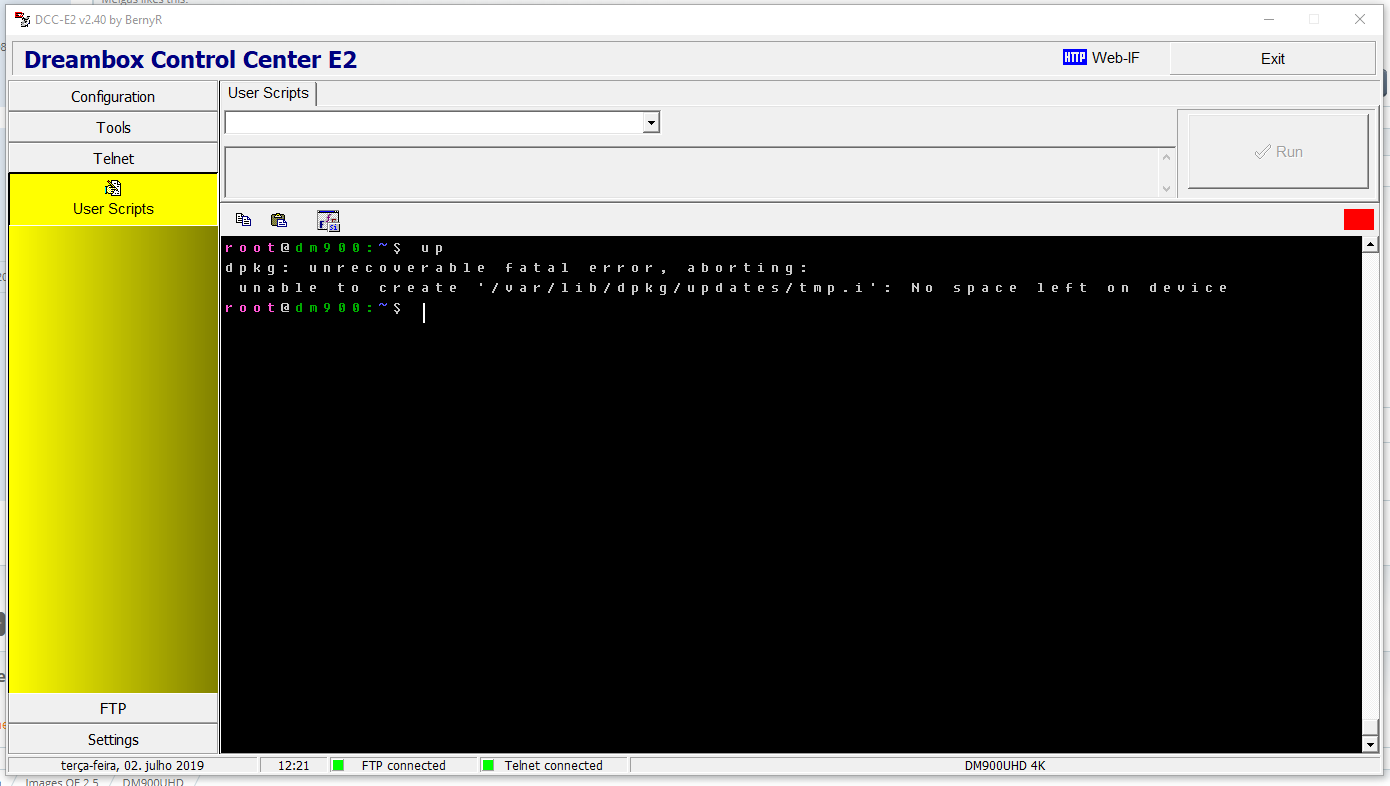

Shutdown the box , pull out the stick , power on the box and look again in this folder you have the picons.
If the picons are there again, delete the picons ( folders ) over FTP.

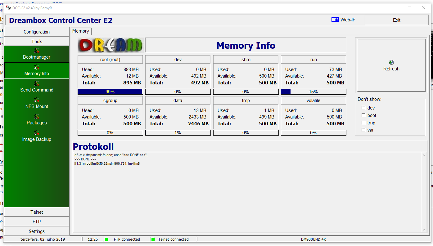

You haved copied the picons not to the stick , you copied it in the flash. -

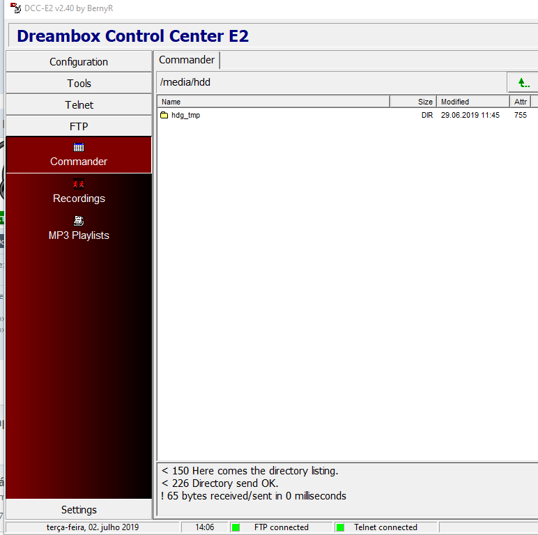

As suggested: in / media / usb I deleted everything.
Before, the files were transferred to a PEN.
I inserted PEN into the USB3 slot and behold, everything is five stars.
