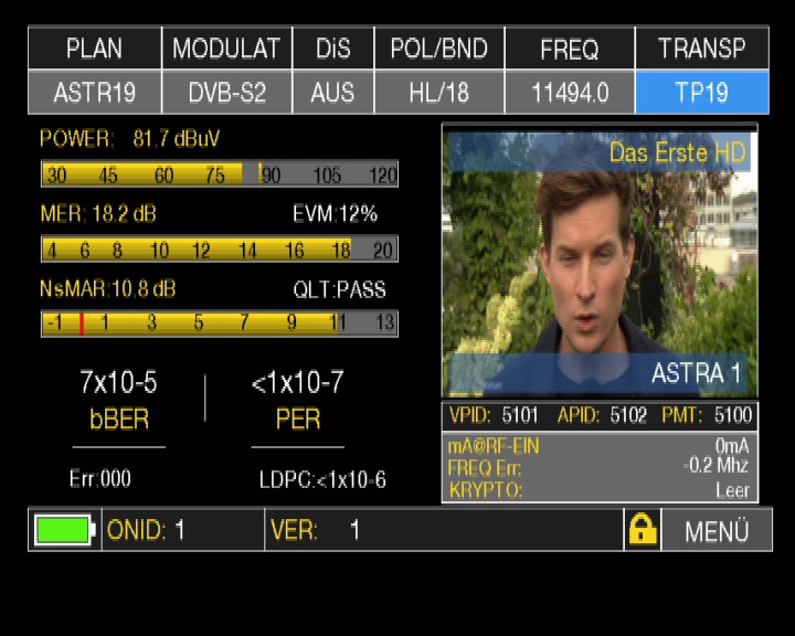

      im in contact with the manufacturer and they confirm uas571 gain50db and 0.8db noise are very bad spec. They attach a picture with a measure taken from 571 but i dont know dish size i suppouse CAS90.
        117,33 kB, 720×576, 238 mal angesehen
