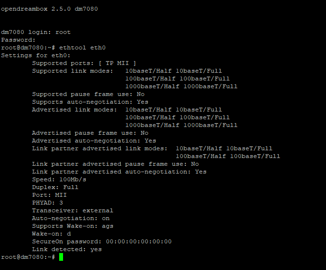

ethtool eth0 -
yes the result is this:
The box is connected by 100Mbit
check your switch / router / cable .... -
Put the cable in the lan-port on your router were the pc is.
Some router have ports for 1000mbit and for 100mbit or you can config it.
it is not a problem of your Dreambox. -
