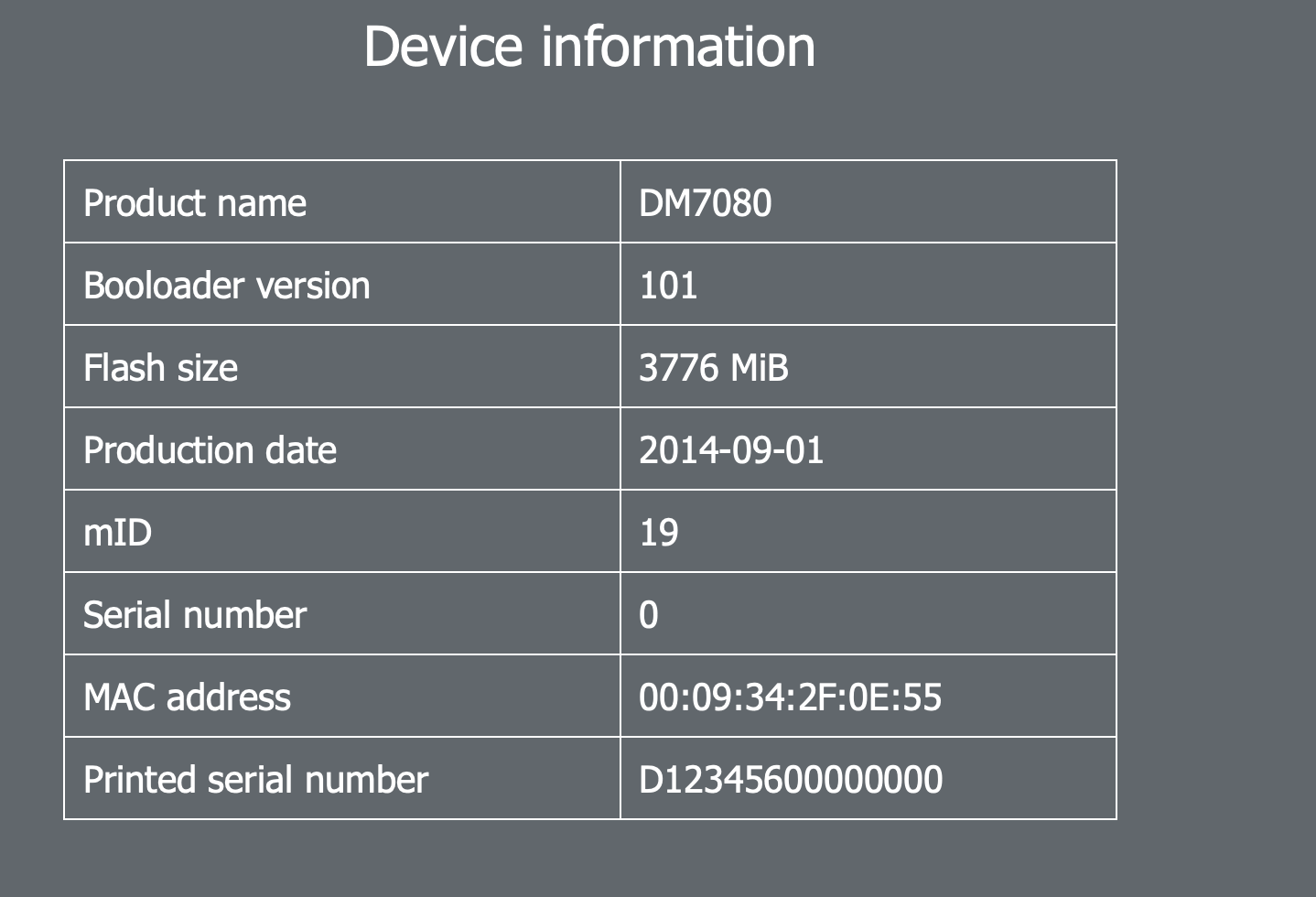

    [*] Creating ext4 filesystem 'dreambox-rootfs' on /dev/mmcblk0p1mke2fs 1.42.8 (20-Jun-2013)Filesystem label=dreambox-rootfsOS type: LinuxBlock size=4096 (log=2)Fragment size=4096 (log=2)Stride=0 blocks, Stripe width=0 blocks60928 inodes, 243712 blocks12185 blocks (5.00%) reserved for the super userFirst data block=0Maximum filesystem blocks=2516582408 block groups32768 blocks per group, 32768 fragments per group7616 inodes per groupSuperblock backups stored on blocks: 32768, 98304, 163840, 229376Allocating group tables: 0/8 done Writing inode tables: 0/8 done Leider komme ich nicht weiter! der Rescue Loader hat die Version 1.01
    Device information
    Product nameDM7080
    Booloader version101
    Flash size3776 MiB
    Production date2014-09-01
    mID19
    Serial number0
    MAC address00:09:34:2F:0E:55
    Printed serial numberD12345600000000
    Was kann ich machen? Wenn ich den in telnet bin erkennt er die update befehle nicht!
