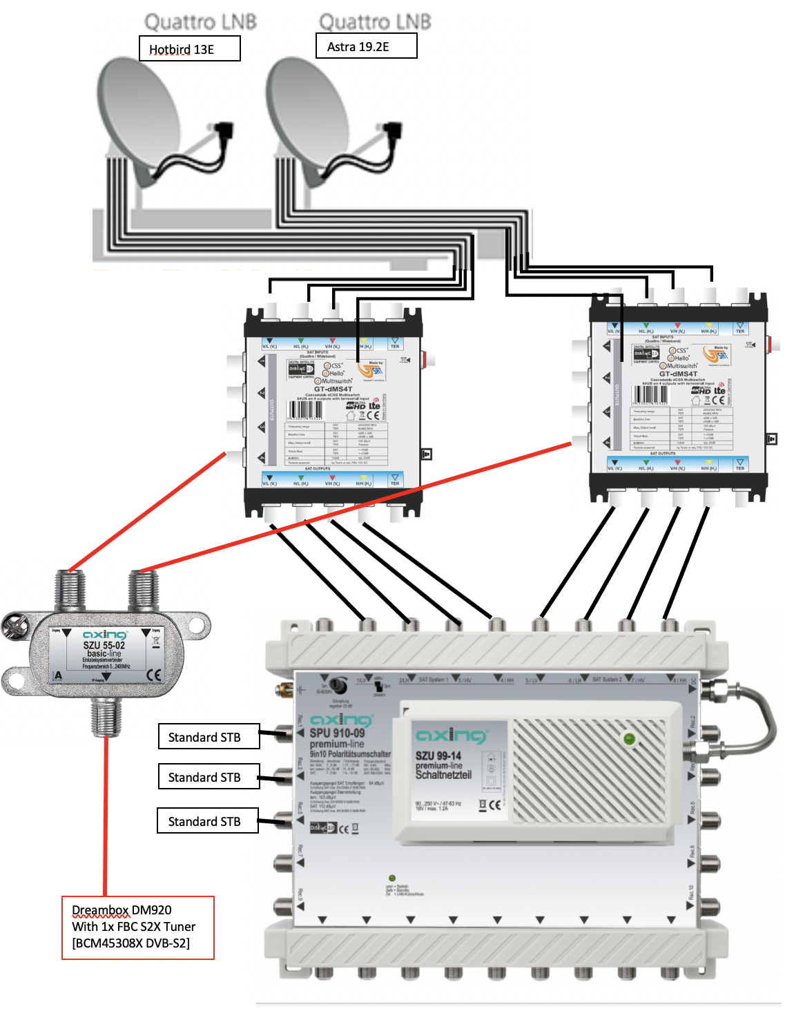

I am not able to configure in my Dreambox DM920 (newnigma2) a simple Unicable connection as shown on the attached Picture.
Please help - please show/write how the tuner configuration should look like (the DM920 is equipped with one FBC S2X Multistream Tuner).

1x Axing SZU 55-2 Singlecable System Combiner
1x Axing SPU 9 in 10 Multiswitch for standard STB's
Please see attachment.
![](https://board.newnigma2.to/wbb4/index.php/Attachment/48725-Unicable-problem-png/?s=fba17305cf0ab1cf623dbc311a7601d86caba586)
I have added to the unicable.xml this (as Unicable Matrix) and use it in the Tuner Config.:
