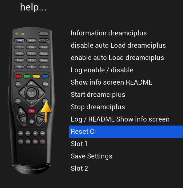

      I've installed Gutemine plugin + autopin + dreamciplus and set it up according to the recommendations.
      However the channels don't seem to get opened.

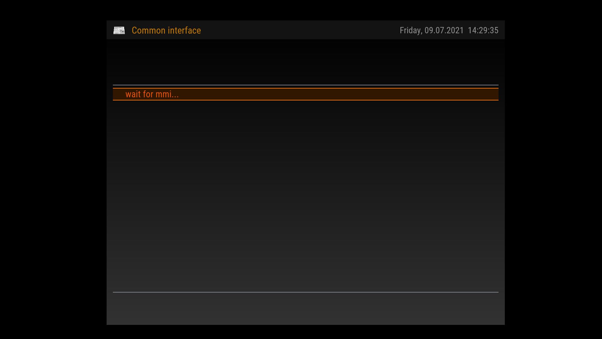

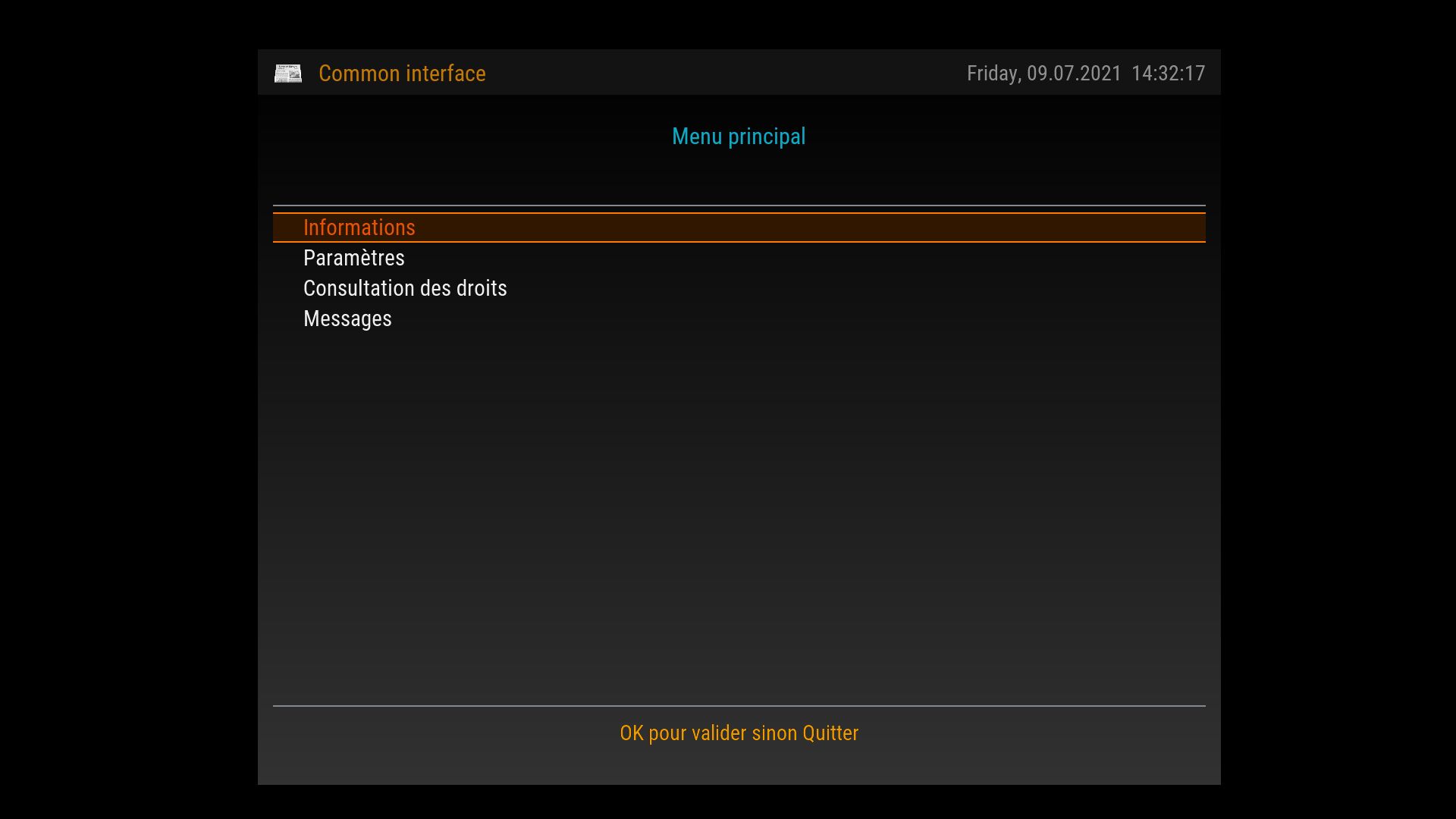

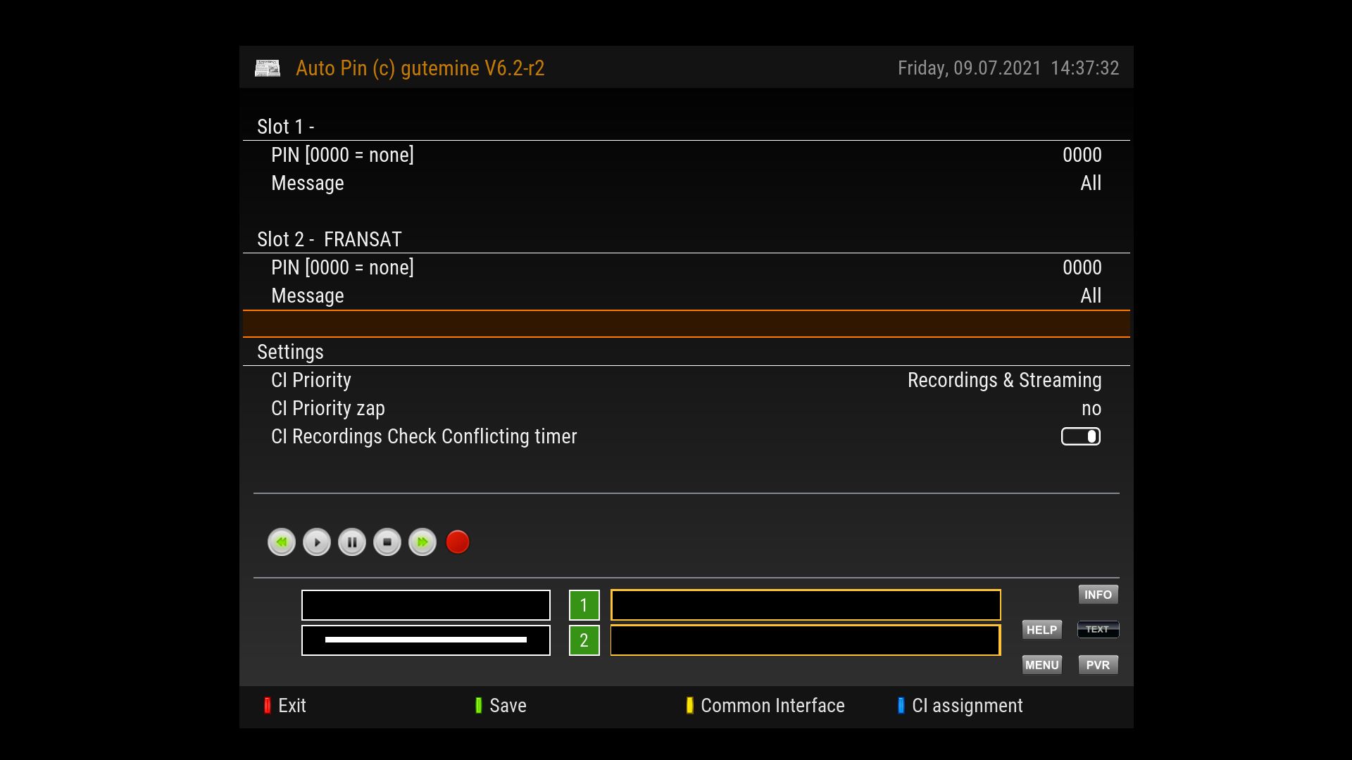

      The CI+ CAM is definitely seen by the box as the box mentions its name in the menu (see screenshot 1) but seems to suffer to read the mmi info of it (see screenshot 2). Sometimes it gets it and sometimes it does not (see screenshot 3).
      Please note the the CI+ device is absolutely functional. It works perfectly in the other two DM920 or directly in my TV.
      Autopin seems to see the device though. (see screenshot 4)

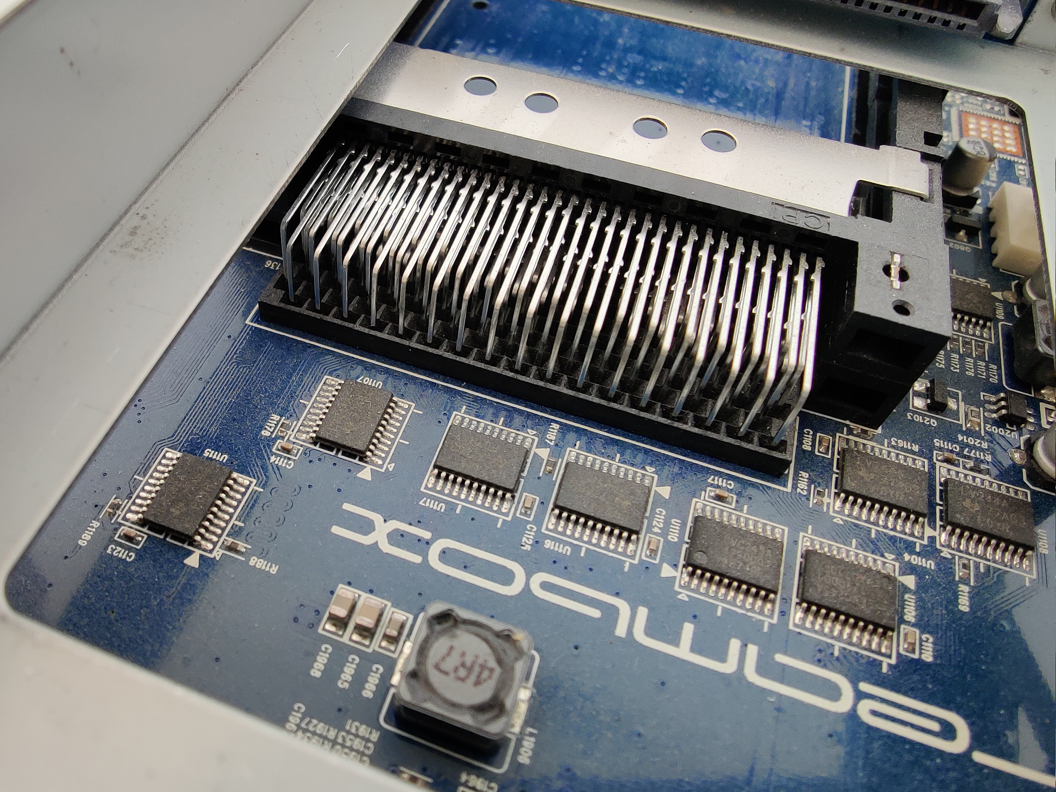

    • the module has not yet been authenticated.
      Dreamciplus is restarted again and again. There is an error.
      Maybe there is a problem with the CI slot. Pins ok ?
      Spoiler anzeigen
      [DCP 2021-07-10 00:14:54] CI1 CA_RESTART
      [DCP 2021-07-10 00:14:54] CI1 RESTART ...
      [DCP 2021-07-10 00:14:54] CI1 REMOVING name file CI_2_FRANSAT
      [DCP 2021-07-10 00:14:54] EPOLL_CTL_DEL CAMD error
      [DCP 2021-07-10 00:14:54] CI1 RESTARTING ...
      Try the other slot if it works.
      There were also Dreamboxes where the Slots were defect.

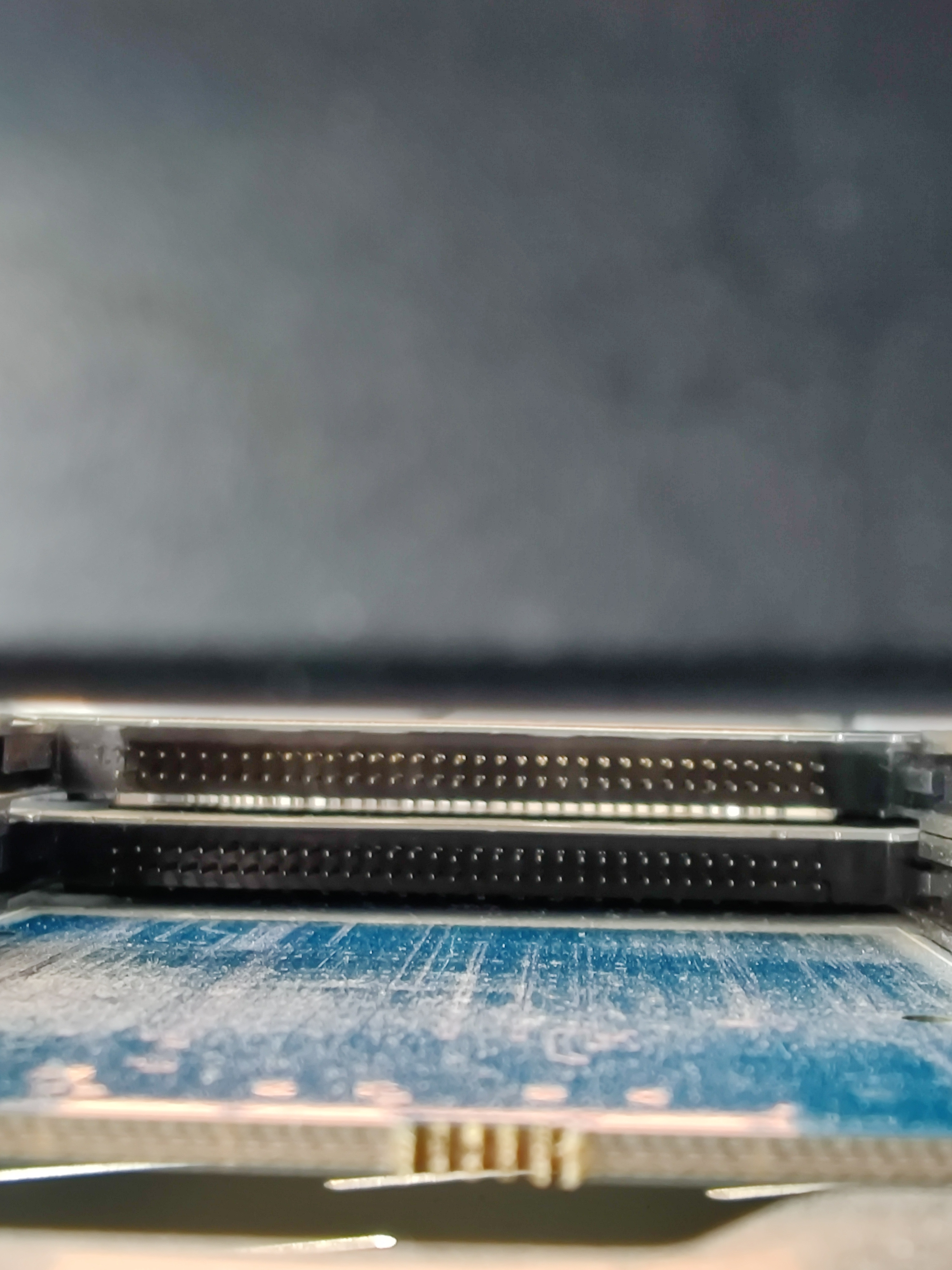

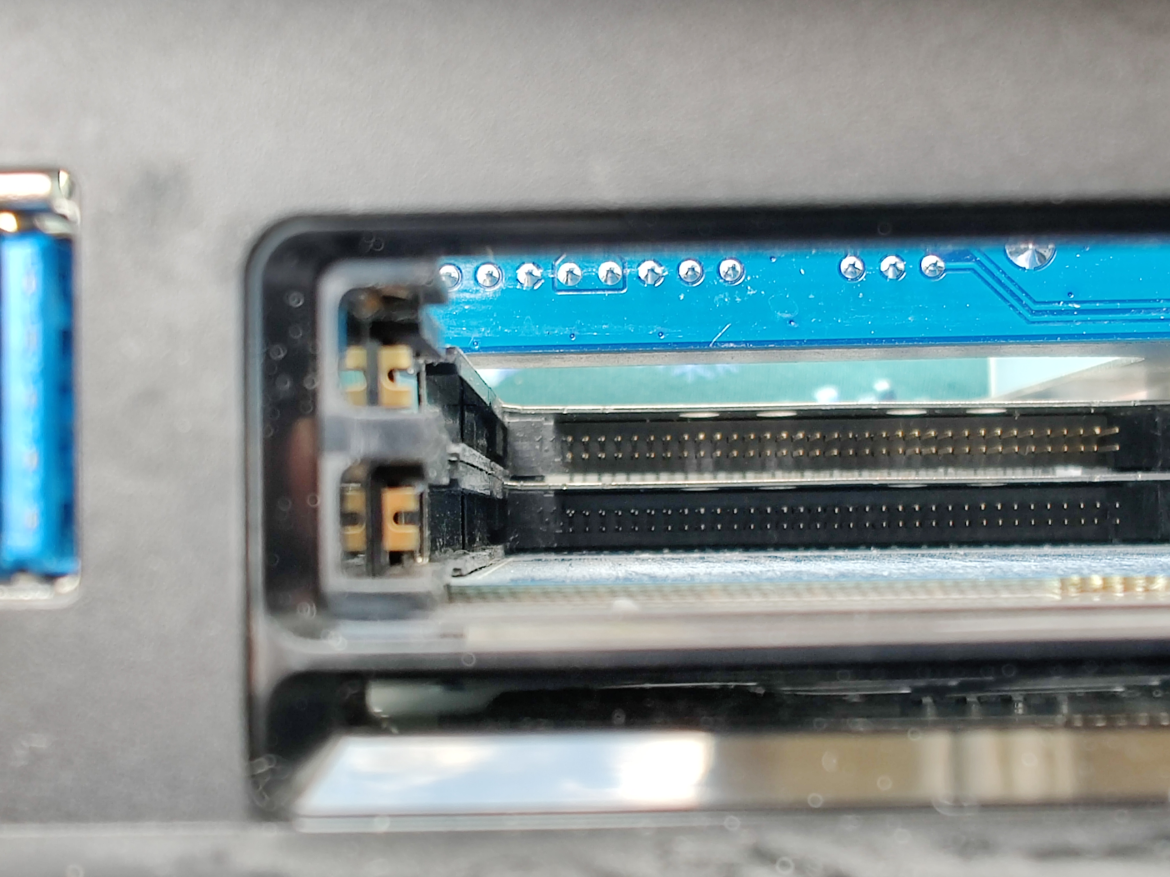

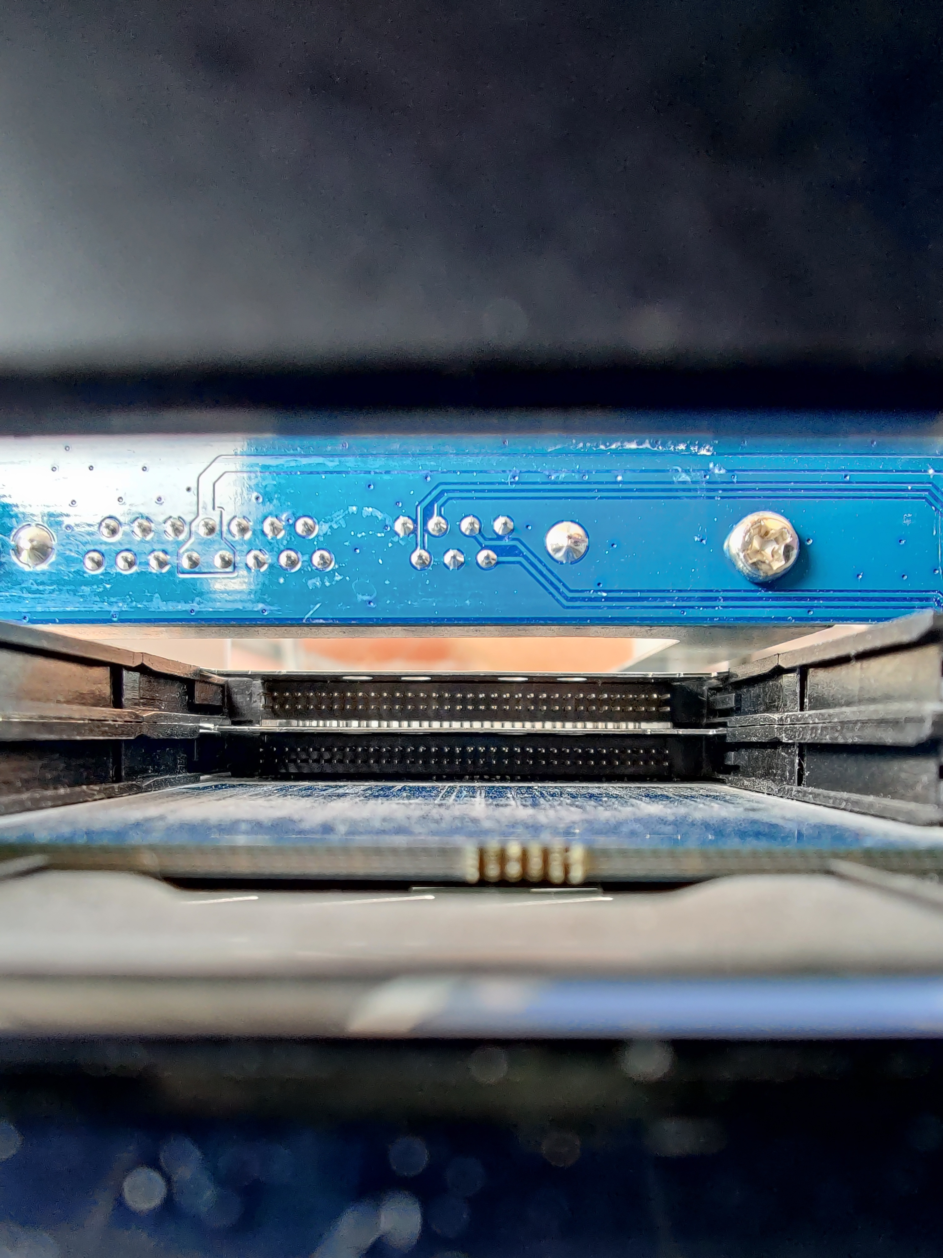

    • Thanks for the suggestion, gutemine. But it didn't change it unfortunately.
      I've checked once again all the pins and they seem totally alright (see pictures).
      If the slots are defect I guess they should not even be able to read the smartcard info's or neither CAM info's.
      Here I can access all these details so it makes me believe it should work then...

        3,97 MB, 4.000×3.000, 695 mal angesehen
        2,43 MB, 4.000×3.000, 681 mal angesehen
        2,38 MB, 3.000×4.000, 689 mal angesehen
        1,62 MB, 3.000×4.000, 672 mal angesehen
