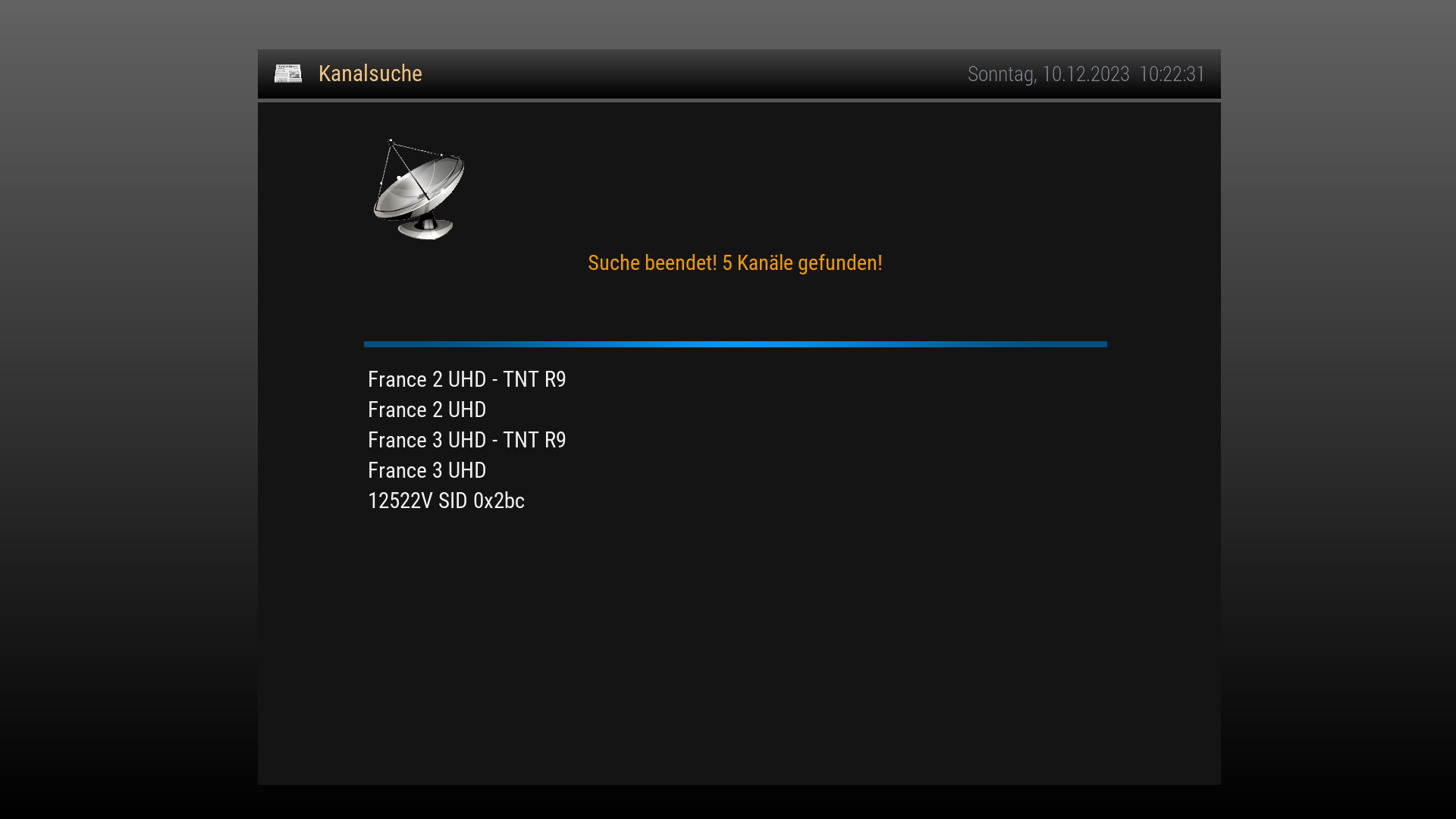

      Good morning,
      I have downloaded Channels France 2&3 on 5 West (Freq 12522 V DVB-S2/8PSK 29950 2/3) on my Dreambox 900UHD
      but when I try to find them on my channel List they don't appear.
      When I try with my Octagon SF800F it's ok I can download them and also find them in my channel list. N.B. I am using Newnigma for my Dreambox 900UHD
      Any suggestions Please.
      Thanks in Advance.
    • The reason is very simple to explain. The channels were recognized as data channels, that´s why they are not displayed. Simply read it out with Dreamboxedit, filter the data channels and change the channel type to 31. Store and restore it in your dreambox and the channels should be where they belong. Have a nice sunday.
    • Hi,
      can you fix in py the display of UHD programs France 2 and 3 of 5 West 12522 V ?
      Scan finds them, but no longer displays them.
      02be:0dde0000:50dc:055f:32:0
      1. 02bc:0dde0000:50dc:055f:100:0
      2. 12522V SID 0x2bc
      3. p:DVB-S2 8PSK 12522V 355.0°E
      4. 02be:0dde0000:50dc:055f:32:0
      5. France 2 UHD - TNT R9
      6. p:EUTELSAT,c:000bcd,c:030bcd,c:050006,c:100007,c:110bd8,C:0500
      7. 02bf:0dde0000:50dc:055f:32:0
      8. France 2 UHD
      9. p:EUTELSAT,c:000bcd,c:030bcd,c:050006,c:100007,c:110bd8,C:0500
      10. 02c1:0dde0000:50dc:055f:32:0
      11. France 3 UHD - TNT R9
      12. p:EUTELSAT,c:000beb,c:030beb,c:050006,c:100007,c:110bf6,C:0500
      13. 02c2:0dde0000:50dc:055f:32:0
      14. France 3 UHD
      15. p:EUTELSAT,c:000beb,c:030beb,c:050006,c:100007,c:110bf6,C:0500
