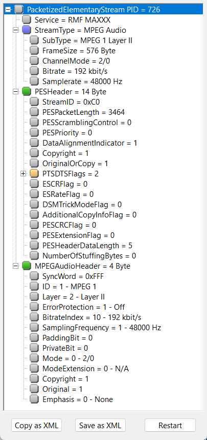

    • after scan - no sound
      1. 1c9e:00820000:1ce8:0071:2:0
      2. RMF MAXXX r bezPCR
      3. p:Cyfrowy Polsat S.A.,c:0102d6,c:031fff
      after manual update (added flag 4) - sound OK
      2. RMF MAXXX withoutPCR
      3. p:Cyfrowy Polsat S.A.,c:0102d6,f:4
      Dreambox 7020HD , 500HD , 7020S , 500S + Gibertini OP100 /50W~90E/

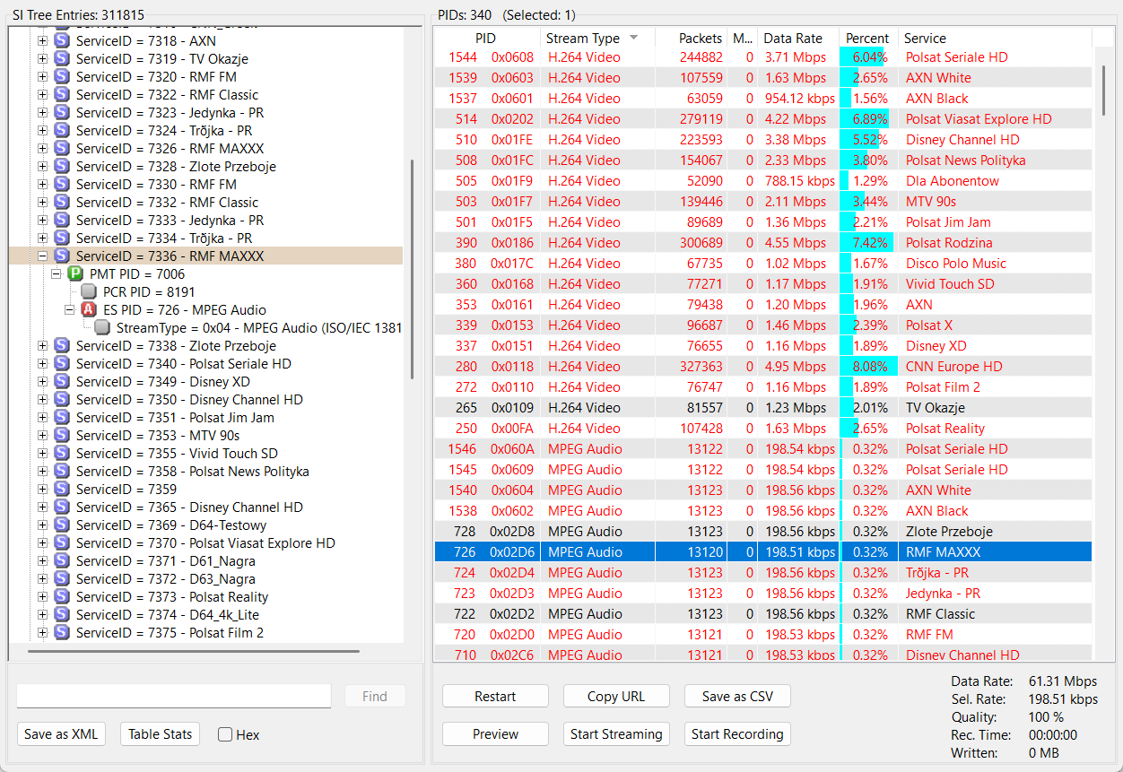

    • pl.kingofsat.net/radiopack-polsat.php
      Muzo FM- ----this station was turned off completely at the beginning of 2023.
      RMF FM, RMF MAXXX, RMF Classic, Zlote Przeboje, Jedynka-PR, Trójka-PR,
      All these radio stations do not works OE 2.6 on PCR=8191.
      I am scaning, search ok, not audio.
      It only works on PID Audio only, but also only for restarting the decoder or restarting the GUI.
      And then he doesn't work again.

      There is something to this PCR, there must be another one and it must be correct. And not this defective 8191.
      Check radio station: RMF FM and see what's going on with it.
      RMF FM, Jedynka-PR, Trójka-PR working flags 3, only restart dekoder, restart GUI NOT WORKS, NOT AUDIO!
      Why?
      And why doesn't RMF MAXX, RMF Classic, Zlote Przeboje play immediately after scanning, but some PIDS have to be
      entered and with PCR it doesn't work at all and there is silence and no audio?
