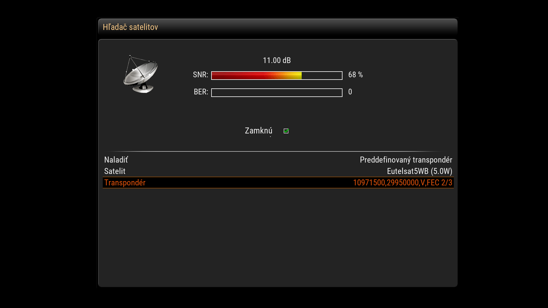

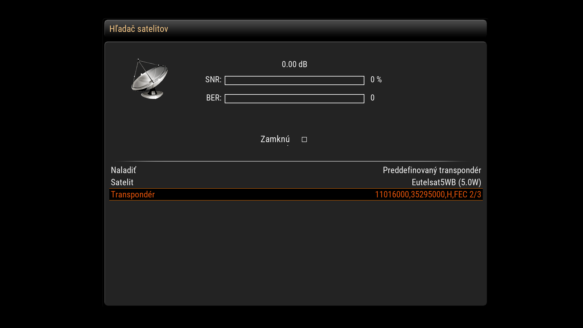

    • Is it possible to correct the signal display in OE2.5/QE2.6 if the satellites.xml uses MIS?
      without MIS no problem
      1. [ 276.374997@0] si2183(0): DVB-S(2) voltage is 13V now
      2. [ 276.384311@5] si2183(0): start tune freq 1221000, sr 29950000, delsys 6
      3. [ 276.481493@0] si2183(0): found carrier after 96 ms
      4. [ 276.505504@0] si2183(0): final lock after 120 ms
      with MIS show none signal
      1. 315.194584@0] si2183(0): start tune freq 1266000, sr 35295000, delsys 6
      2. [ 315.289495@0] si2183(0): found carrier after 96 ms
      3. [ 317.697484@0] si2183(0): tune timeout!

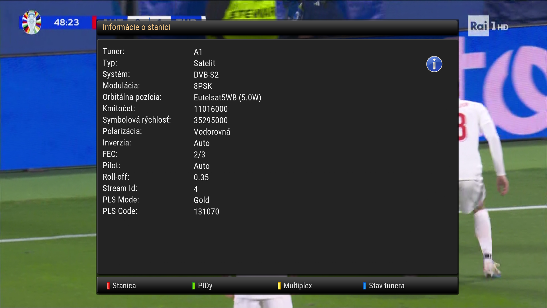

      if scan is started from satellites.xml then MIS is detected and tuned
      1. [ 4395.422115@3] dmx0: DMX_SET_SOURCE 0
      2. [ 4395.422767@5] si2183(0): DVB-S(2) voltage is 13V now
      3. [ 4395.446693@0] si2183(0): start tune freq 1221500, sr 29950000, delsys 6
      4. [ 4395.543407@0] si2183(0): found carrier after 112 ms
      5. [ 4395.567502@0] si2183(0): final lock after 136 ms
      6. [ 4397.437046@0] si2183(0): DVB-S(2) voltage is 18V now
      7. [ 4397.446412@0] si2183(0): start tune freq 1266000, sr 35295000, delsys 6
      8. [ 4397.446549@0] si2183(0): IS_ID 1
      9. [ 4397.446914@0] si2183(0): PLS_MODE 1, PLS_CODE 131070
      10. [ 4397.456938@1] si2183(0): PLS Gold code 131070 set
      11. [ 4397.551407@1] si2183(0): found carrier after 104 ms
      12. [ 4397.623403@1] si2183(0): final lock after 176 ms
      13. [ 4398.382854@1] si2183(0): start tune freq 1266000, sr 35295000, delsys 6
      14. [ 4398.382988@1] si2183(0): IS_ID 4
      15. [ 4398.383353@1] si2183(0): PLS_MODE 1, PLS_CODE 131070
      16. [ 4398.394234@1] si2183(0): PLS Gold code 131070 set
      17. [ 4398.491418@1] si2183(0): found carrier after 108 ms
      18. [ 4398.539394@1] si2183(0): final lock after 156 ms
      19. [ 4399.160325@1] si2183(0): start tune freq 1266000, sr 35295000, delsys 6
      20. [ 4399.160461@1] si2183(0): IS_ID 9
      21. [ 4399.160824@1] si2183(0): PLS_MODE 1, PLS_CODE 131070
      22. [ 4399.173877@1] si2183(0): PLS Gold code 131070 set
      23. [ 4399.271422@0] si2183(0): found carrier after 112 ms
      24. [ 4399.319451@0] si2183(0): final lock after 160 ms
      25. [ 4399.664126@0] si2183(0): DVB-S(2) voltage is 13V now
      26. [ 4399.673644@0] si2183(0): start tune freq 1304500, sr 29950000, delsys 6
      27. [ 4399.767390@0] si2183(0): found carrier after 96 ms
      28. [ 4399.791431@0] si2183(0): final lock after 120 ms
