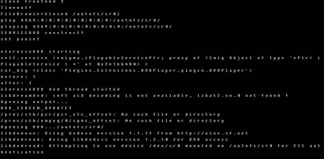

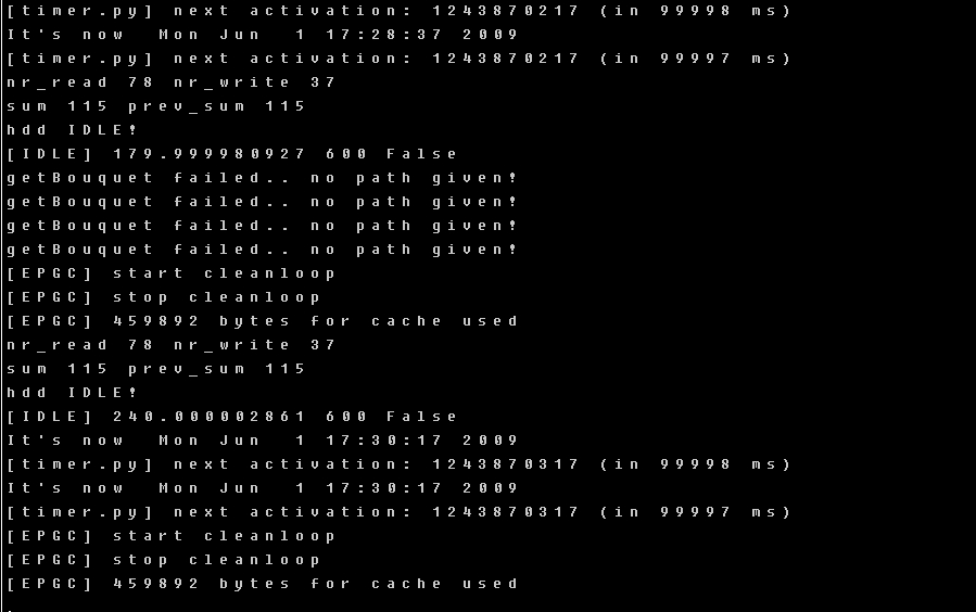

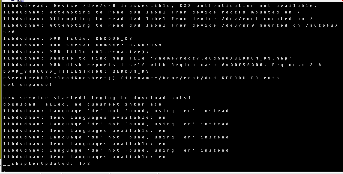

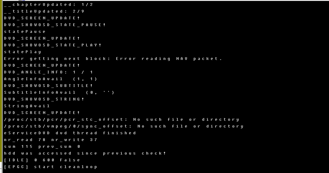

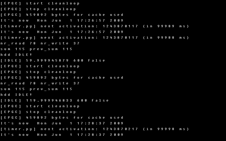

    • Original von nixkoenner
      @gerbi
      telnet boxip
      ipkg list_installed libdvdread*
      init 4
      enigma2.sh
      was kommt im log beim abspielen der dvd ?
      kann man damit was anfangen?
      Vielen Dank
      gerbi

    • nee nicht wirklich
      was liefert ipkg list_installed libdvdread* zurück ?
      dann besorg die mal putty und schalte da logfile an :D

    • ja sowas z.b.
      libdvdnav: Using dvdnav version 1.1.12 from xine.sf.net
      libdvdread: Using libdvdcss version 1.2.10 for DVD access
      libdvdread: Attempting to use device /dev/sr0 mounted on /autofs/sr0 for CSS authentication
      libdvdread: Could not open /dev/sr0 with libdvdcss.
      libdvdread: Can't open /dev/sr0 for reading
      libdvdread: Device /dev/sr0 inaccessible, CSS authentication not available.
      libdvdnav: Attempting to read dvd label from device rootfs mounted on /
      libdvdnav: Attempting to read dvd label from device /dev/root mounted on /
      libdvdnav: Attempting to read dvd label from device /dev/sr0 mounted on /autofs/sr0
      libdvdnav: DVD Title: GEDDON_D3
      libdvdnav: DVD Serial Number: 376A7D69
      libdvdnav: DVD Title (Alternative):
      libdvdnav: Unable to find map file '/home/root/.dvdnav/GEDDON_D3.map'
      libdvdnav: DVD disk reports itself with Region mask 0x00f50000. Regions: 2 4
      hast du den regio code am dvd-laufwerk gesetzt ?
