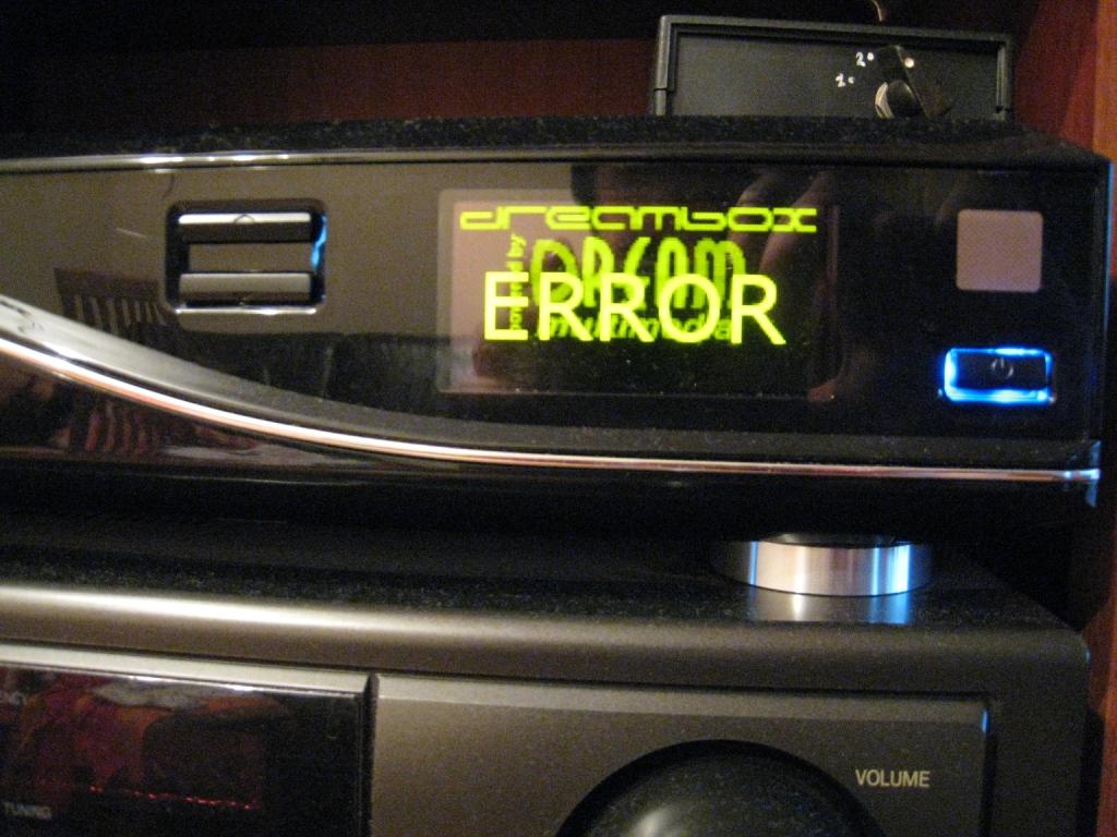

'ERROR' displayed on front pannel !?
    • 'ERROR' displayed on front pannel !?
      what can be that?
      it didnt come after reflash or online update, just after deep standby
      image in flash - 090910_dm8k_Newnigma2-snapshot-20090910060058.nfi
      online update - 090912
      tryed start with power switch and take away pover for ~10min - nothing changed
      then tryed start with pushed down button on front pannel - after that box starting and restarting normaly
        109,87 kB, 1.024×768, 857 mal angesehen

    • Hello,
      the security card was not properly fixed. She had come loose.
      The box I have posted.
      Die security Card war nicht richtig befestigt. Sie hatte sich gelöst.
      Die Box habe ich eingeschickt.
