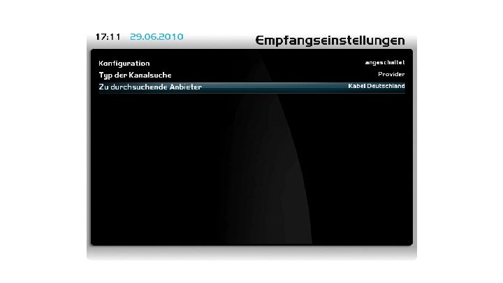

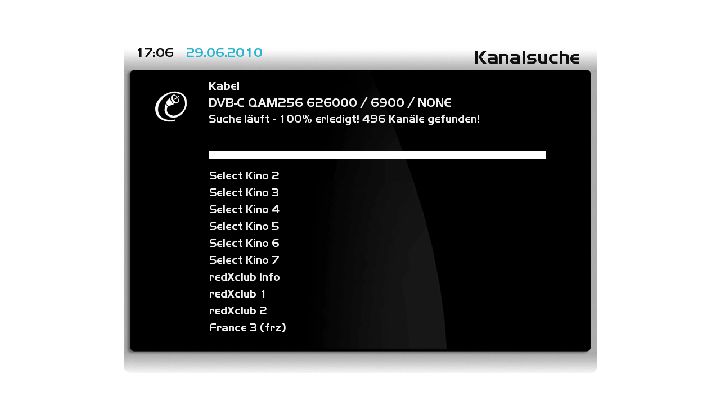

    • Aber sicher doch, sonst heißt es wieder der Audioslyer macht immer Andeutungen ;o) Die frequency muss 3 Nullen mehr haben in der cables.xml
      Nutze Newnigma. Die Cables von Tuxbox könnt ihr nehmen.
      1. <cable name="Kabel Deutschland" flags="9">
      2. <transponder frequency="73000000" symbol_rate="6900000" fec_inner="9" modulation="6"/>
      3. <transponder frequency="113000000" symbol_rate="6900000" fec_inner="9" modulation="6"/>
      4. <transponder frequency="121000000" symbol_rate="6900000" fec_inner="9" modulation="6"/>
      5. <transponder frequency="322000000" symbol_rate="6900000" fec_inner="9" modulation="6"/>
      6. <transponder frequency="330000000" symbol_rate="6900000" fec_inner="9" modulation="6"/>
      7. <transponder frequency="338000000" symbol_rate="6900000" fec_inner="9" modulation="6"/>
      8. <transponder frequency="346000000" symbol_rate="6900000" fec_inner="9" modulation="6"/>
      9. <transponder frequency="354000000" symbol_rate="6900000" fec_inner="9" modulation="6"/>
      10. <transponder frequency="362000000" symbol_rate="6900000" fec_inner="9" modulation="6"/>
      11. <transponder frequency="370000000" symbol_rate="6900000" fec_inner="9" modulation="6"/>
      12. <transponder frequency="378000000" symbol_rate="6900000" fec_inner="9" modulation="6"/>
      13. <transponder frequency="386000000" symbol_rate="6900000" fec_inner="9" modulation="6"/>
      14. <transponder frequency="394000000" symbol_rate="6900000" fec_inner="9" modulation="6"/>
      15. <transponder frequency="402000000" symbol_rate="6900000" fec_inner="9" modulation="6"/>
      16. <transponder frequency="410000000" symbol_rate="6900000" fec_inner="9" modulation="6"/>
      17. <transponder frequency="426000000" symbol_rate="6900000" fec_inner="9" modulation="6"/>
      18. <transponder frequency="434000000" symbol_rate="6900000" fec_inner="9" modulation="6"/>
      19. <transponder frequency="442000000" symbol_rate="6900000" fec_inner="9" modulation="6"/>
      20. <transponder frequency="450000000" symbol_rate="6900000" fec_inner="9" modulation="6"/>
      21. <transponder frequency="458000000" symbol_rate="6900000" fec_inner="9" modulation="6"/>
      22. <transponder frequency="466000000" symbol_rate="6900000" fec_inner="9" modulation="6"/>
      23. <transponder frequency="498000000" symbol_rate="6900000" fec_inner="9" modulation="6"/>
      24. <transponder frequency="522000000" symbol_rate="6900000" fec_inner="9" modulation="6"/>
      25. <transponder frequency="530000000" symbol_rate="6900000" fec_inner="9" modulation="6"/>
      26. <transponder frequency="538000000" symbol_rate="6900000" fec_inner="9" modulation="6"/>
      27. <transponder frequency="610000000" symbol_rate="6900000" fec_inner="9" modulation="6"/>
      28. <transponder frequency="618000000" symbol_rate="6900000" fec_inner="9" modulation="6"/>
      29. <transponder frequency="626000000" symbol_rate="6900000" fec_inner="9" modulation="6"/>
      30. </cable>
