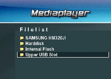

    • Hi,
      You do not need to mount - just plug in USB stick and you will see in Media Player file menu. I have NTFS file system on stick but maybe FAT also working - I did not tested.
