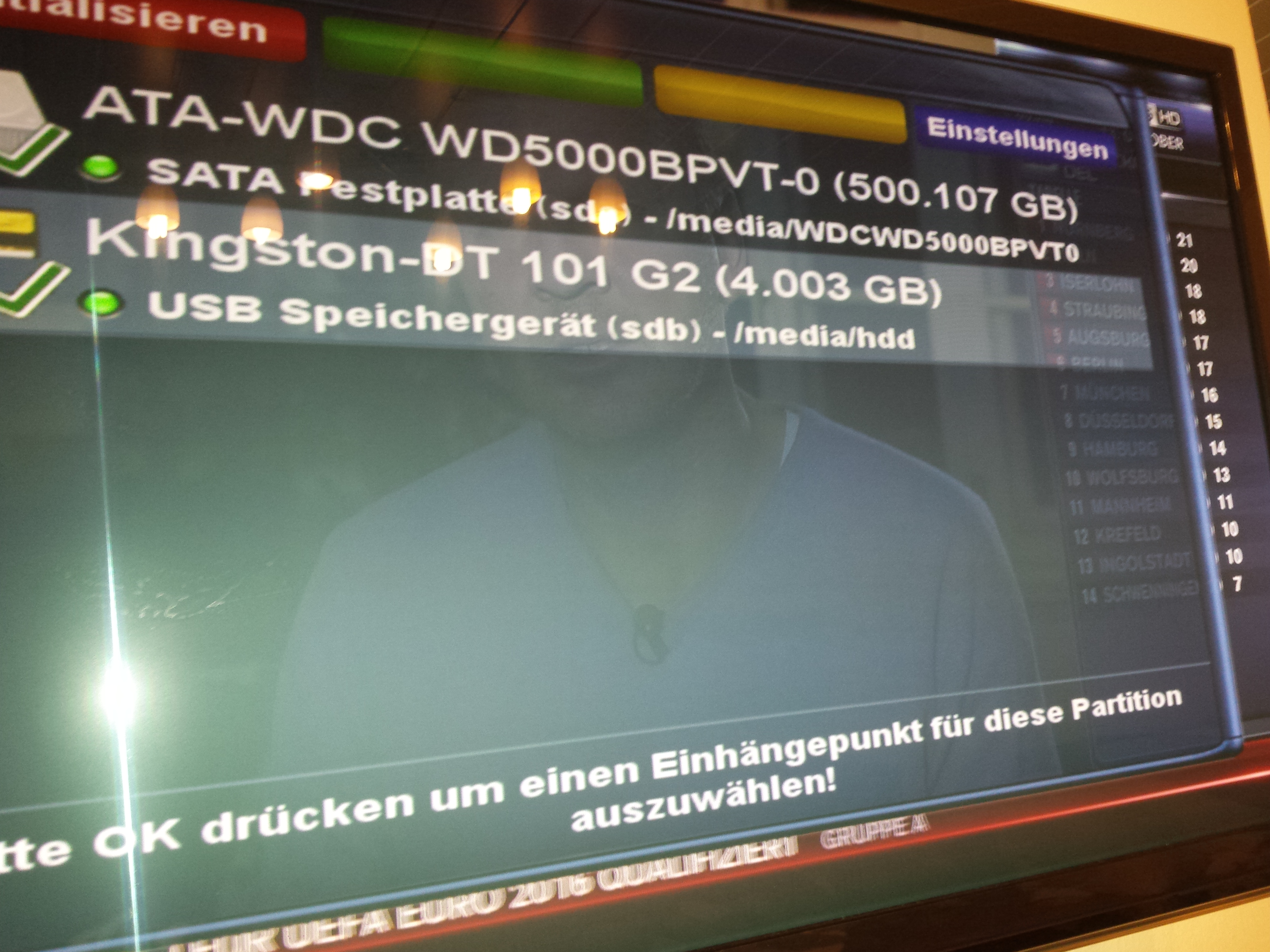

hallo nochmal ich hoffe das passt jetz soo
* newnigma2.to *
* the next step is done *
opendreambox 2.0.0 dm800se
dm800se login: root
root@dm800se:~# mkfs.ext4 -N 30000 /dev/sdb1
mke2fs 1.42.1 (17-Feb-2012)
Filesystem label=
OS type: Linux
Block size=4096 (log=2)
Fragment size=4096 (log=2)
Stride=0 blocks, Stripe width=0 blocks
30240 inodes, 977403 blocks
48870 blocks (5.00%) reserved for the super user
First data block=0
Maximum filesystem blocks=1002438656
30 block groups
32768 blocks per group, 32768 fragments per group
1008 inodes per group
Superblock backups stored on blocks:
32768, 98304, 163840, 229376, 294912, 819200, 884736
Allocating group tables: done
Writing inode tables: done
Creating journal (16384 blocks): done
Writing superblocks and filesystem accounting information: done
root@dm800se:~# df -h
Filesystem Size Used Available Use% Mounted on
/dev/root 59.0M 46.8M 12.2M 79% /
devtmpfs 65.9M 0 65.9M 0% /dev
none 66.0M 1.1M 64.8M 2% /var/volatile
/dev/loop0 2.3M 2.3M 0 100% /media/squashfs-images/dreambox-dvb-modules-sqsh-img
/dev/loop1 5.3M 5.3M 0 100% /media/squashfs-images/qt4-embedded-core-sqsh-img
none 66.0M 0 66.0M 0% /dev/shm
/dev/mtdblock2 3.8M 3.2M 568.0K 85% /boot
/dev/disk/by-uuid/a4180f24-407b-4e45-8a02-a9b3fb8d24f3
464.6G 11.6G 453.0G 3% /media/WDCWD5000BPVT0
/dev/disk/by-uuid/09b13904-5f4d-4e34-bfa7-a1d20559048a
3.7G 71.5M 3.5G 2% /media/hdd
root@dm800se:~#

danke euch
jetz wüst ich noch allzugerne wohin mann die picons instalieren muss flash oder auf usb wo flooder laüft -
Egal. Wenn Flodder installiert ist, wird das gesamte Root ausgelagert und alles was du in den "Flash" installierst landet auf dem Stick.
ok danke dann gute nacht
