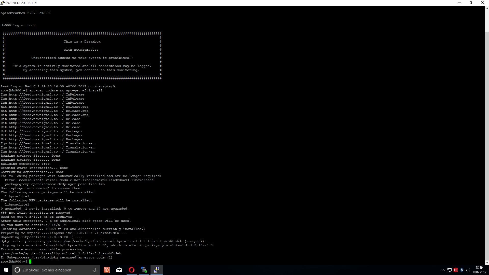

Richi207 schrieb:
Also, habe die
libpcsclite1_1.8.13-r0.1_armhf.deb
auf TMP gemacht, dann
apt-get update ; dpkg --install --force-depends --force-overwrite /tmp/*.deb ; apt-get -y -f install
Edit1.: okay, nochmals "up" und es kamen noch paar updates. scheint jetzt alles zu gehen. DankeAlles anzeigenQuellcode
- E: Some index files failed to download. They have been ignored, or old ones use
- instead.
- (Reading database ... 17398 files and directories currently installed.)
- Preparing to unpack .../libpcsclite1_1.8.13-r0.1_armhf.deb ...
- Unpacking libpcsclite1 (1.8.13-r0.1) ...
- dpkg: warning: overriding problem because --force enabled:
- dpkg: warning: trying to overwrite '/usr/lib/libpcsclite.so.1.0.0', which is al
- o in package pcsc-lite-lib 1.8.13-r0.0
- dpkg: warning: trying to overwrite '/usr/lib/libpcsclite.so.1', which is also i
- package pcsc-lite-lib 1.8.13-r0.0
- Setting up libpcsclite1 (1.8.13-r0.1) ...
- Reading package lists... Done
- Building dependency tree
- Reading state information... Done
- 0 upgraded, 0 newly installed, 0 to remove and 7 not upgraded.
- 1 not fully installed or removed.
- After this operation, 0 B of additional disk space will be used.
- Setting up newnigma2-camd-oscam-modern (svn1524-r5.1) ...
