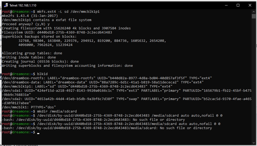

    • Bekomme die SD Karte nicht gemounted. Im letzten Schritt kommt der Fehler:
      Spoiler anzeigen
      1. ***************************** * http://www.newnigma2.to * ***************************** * the next step is done * ***************************** opendreambox 2.6.0 dreamone dreamone login: root ############################################################################## # # # This is a Dreambox # # # # with newnigma2.to # # # # Unauthorized access to this system is prohibited ! # # # # This system is actively monitored and all connections may be logged. # # By accessing this system, you consent to this monitoring. # # # ############################################################################## root@dreamone:~$ mkfs.ext4 -L sd /dev/mmcblk1p1 mke2fs 1.43.4 (31-Jan-2017) /dev/mmcblk1p1 contains a exfat file system Proceed anyway? (y,N) y Creating filesystem with 15626240 4k blocks and 3907584 inodes Filesystem UUID: d440bd18-275b-4369-8748-2c2ecd643483 Superblock backups stored on blocks: 32768, 98304, 163840, 229376, 294912, 819200, 884736, 1605632, 2654208, 4096000, 7962624, 11239424 Allocating group tables: done Writing inode tables: done Creating journal (65536 blocks): done Writing superblocks and filesystem accounting information: done root@dreamone:~$ blkid /dev/dreambox-rootfs: LABEL="dreambox-rootfs" UUID="b440d82a-8977-4d8a-bd04-40d857af3f5f" TYPE="ext4" /dev/dreambox-data: LABEL="dreambox-data" UUID="88a7289c-6d1c-41a1-b819-58a11dececa2" TYPE="ext4" /dev/mmcblk1p1: LABEL="sd" UUID="d440bd18-275b-4369-8748-2c2ecd643483" TYPE="ext4" /dev/sda1: UUID="424ef15d-a218-4927-8143-9920a0166c1c" TYPE="ext3" PARTLABEL="primary" PARTUUID="165679b1-fb22-45bf-b475-9bb9c768831e" /dev/sda2: UUID="4653a42b-44d4-45eb-b5db-9a3bf6c7d38f" TYPE="swap" PARTLABEL="primary" PARTUUID="b52cac5d-9370-4fae-a465-d30f0127abee" /dev/mmcblk1: PTTYPE="dos" root@dreamone:~$ mkdir /media/sdcard root@dreamone:~$ /dev/disk/by-uuid/d440bd18-275b-4369-8748-2c2ecd643483 /media/sdcard auto auto,nofail 0 0 -bash: /dev/disk/by-uuid/d440bd18-275b-4369-8748-2c2ecd643483: No such file or directory root@dreamone:~$ /dev/disk/by-uuid/d440bd18-275b-4369-8748-2c2ecd643483/media/sdcard auto auto,nofail 0 0 -bash: /dev/disk/by-uuid/d440bd18-275b-4369-8748-2c2ecd643483/media/sdcard: No such file or directory root@dreamone:~$
        372,56 kB, 988×562, 387 mal angesehen

    • die letzte zeile kommt in die /etc/fstab
      dann box rebooten
