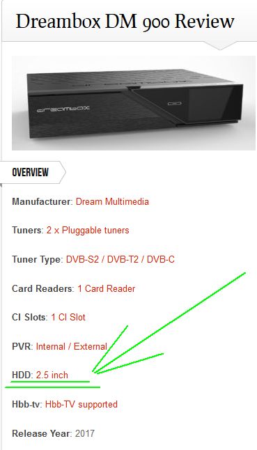

i have a hdd installed on my dm7080 and i would like to use it on my new dm900 its possible or i could use it if both dreams are in the same net.
HDD 3.5 on dm900
Wenn seine beiden Boxen im gleichen Netzwerk hängen, kann er doch von der 900er auf die HDD in der 7080 zugreifen, wenn er die 7080 weiterhin laufen läßt.
That´s why I wrote : second yes
ON a DM9x0? YES
IN a DM9x0? NO
In Germany, we say: bean counter
Thanks all after clarify. to install inside its impossible but there is a manual about the tricky to install outside via usb?
if doesnt works i will try the second option to use the same hdd via the same net i think its easy to choose the same hdd for both dreams.
thanks a lot -

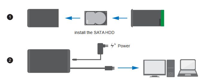

This will do the trick : cdn-reichelt.de/documents/date…LOGILINK_UA0284_DB_EN.pdf
reichelt.de/externes-3-5-sata-…201800.html?&trstct=pol_3
But maybe someone knows more or something better for it .
friendly greetings -

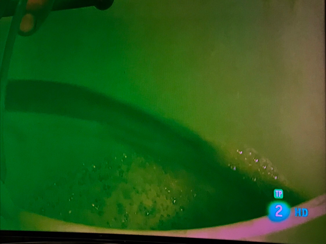

ok thank i will test im right now connecting for first time the dm900 my surprise the screen is green what hell is that ¡¡¡
Directly i install newnigma2 image but still green screen somebody had the same problem with the box new -
Uncheck "Backup current settings before flashing" and "Restore settings after flashing"
Anleitung zum Newnigma2 Image (OE2.5 basiert und neuer) -
yes to install newnigma uncheck back up but after flash i push click to reboot, very strange maybe is brokne this dreambox
there is nothing connected and no crash log could i attachd here a picture of the screen?
Its not a screenshot green is the picture green i can watch the channels but the picture is completly green. I can test with other cable.
I saw options on menu to change bits and hgl but nothing.
I new dreambox bought on ebay but in a normal satshop.
Im afraid i have to send back because the Shop is in germany and me in spain.
Oh my good
Now is solved with the hdmi cable doesnt works fine the cable that i had before for dm7080.

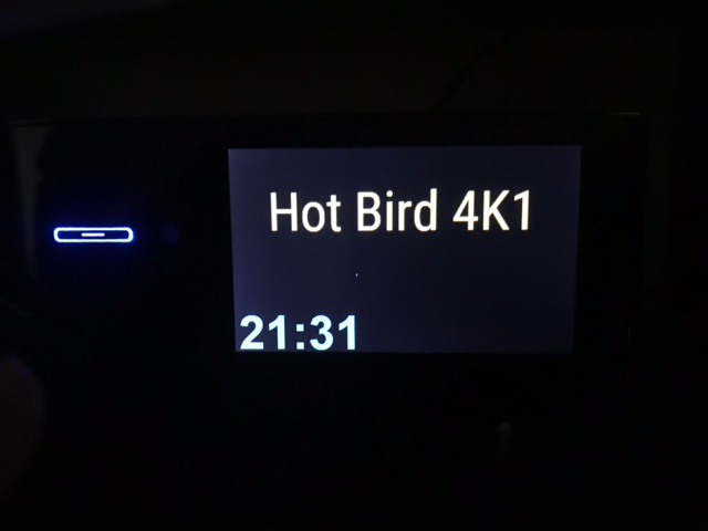

only just to know and not open other thread where i could decrease the intensity of the blue button. The screen i already found i remember there was an option while recording on dm7080 and 8000
