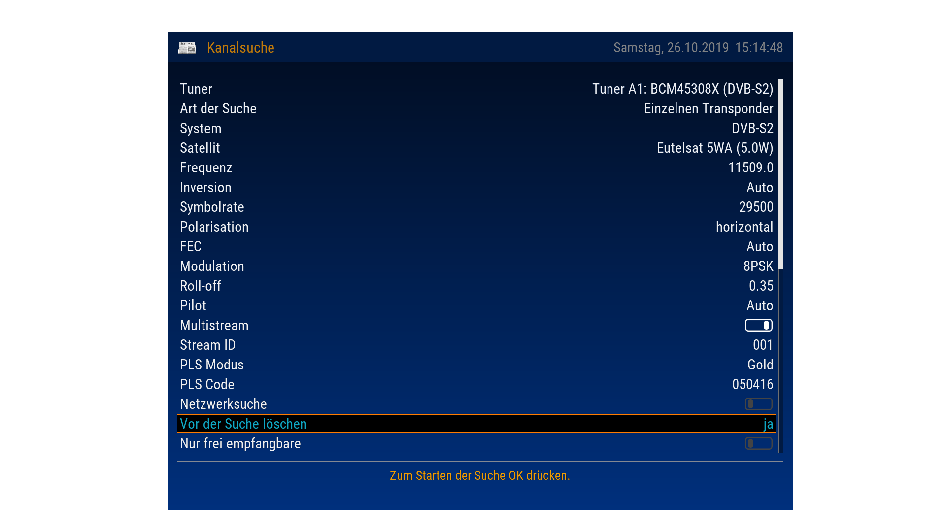

For many days I could not complete a manual scan of the 11508H multistream transponder on 5.0W on my DM920 (equipped with BCM45308 FBC MS tuner).
Correct provision of stream ID, PLS, modulation, etc. did not help! In my desperation, I added a dedicated 100cm dish giving 17,5+dB C/N. No luck with manual scan, blind scan, etc.

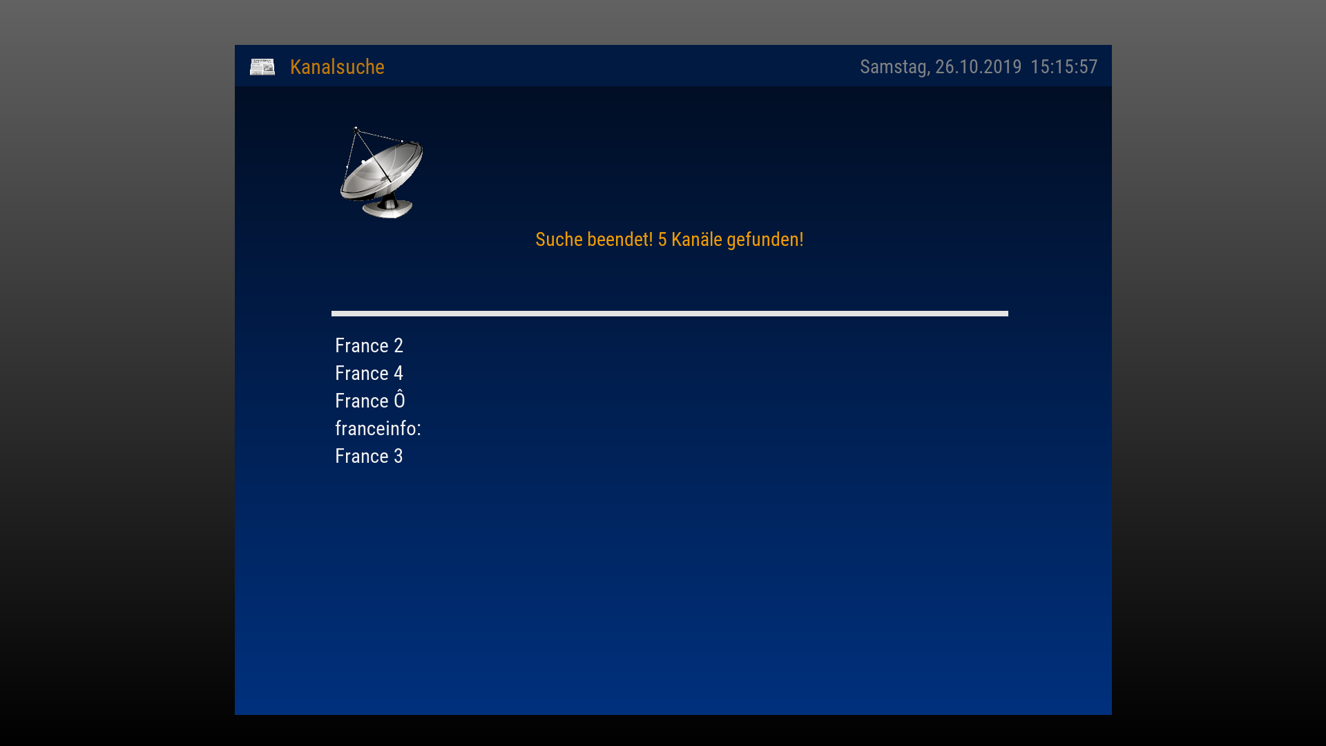

Then, to my surprise, full satellite scan easily revealed all missing multistream services.
