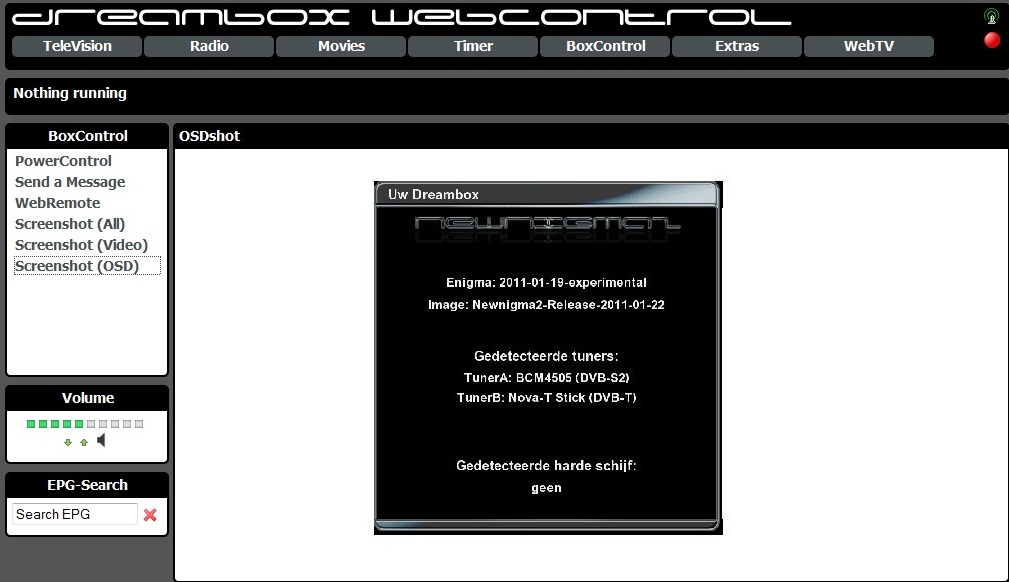

    • I see:
      TUNER A: BCM4505 (DVB-S2)
      Single
      Satellites: Hot Bird 13.0E
      TUNER B: Nova-T Stick (DVB-T)
      Enabled
      I did dtt channels search and all works well.
      If I install only drivers in nn2 feed (v4 and not v47) it doesn't work.

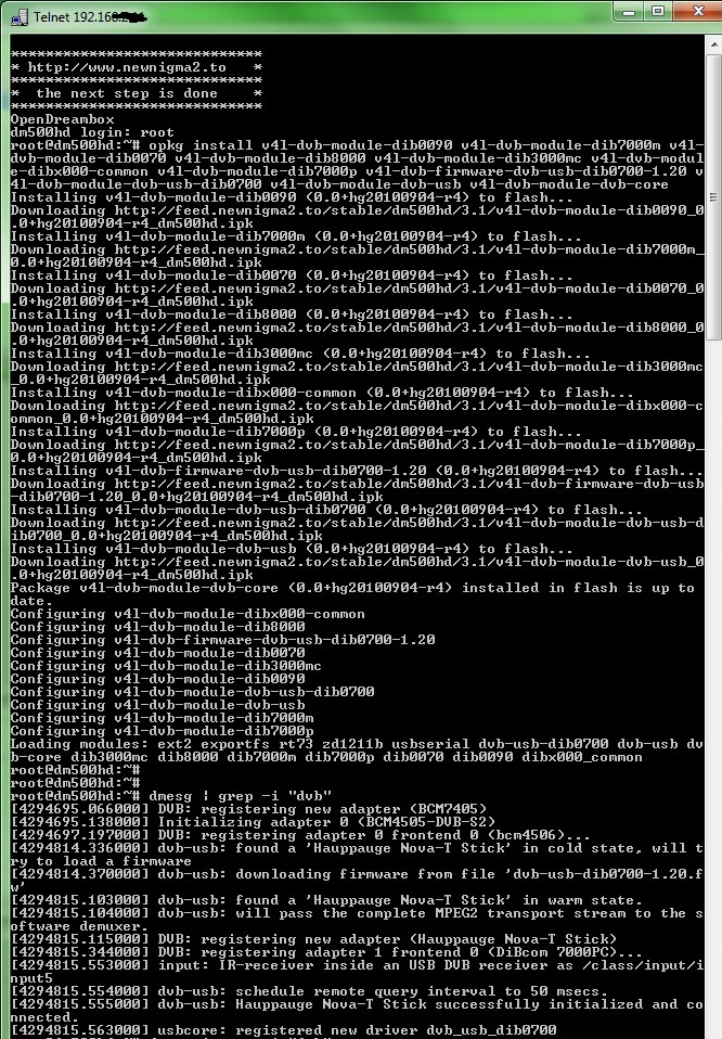

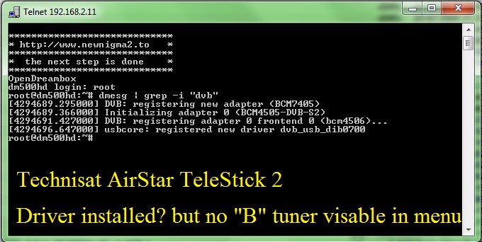

    • Got me a Hauppage NOVA-T stick also, and i had the same problem.
      Been trying to find out what the problem was all day...
      After a lot of re-flashes and reboots i made some progress.
      In witch order the packages are installed seems to be crucial!
      I finally composed a line that you can use in telnet :
      opkg install v4l-dvb-module-dib0090 v4l-dvb-module-dib7000m v4l-dvb-module-dib0070 v4l-dvb-module-dib8000 v4l-dvb-module-dib3000mc v4l-dvb-module-dibx000-common v4l-dvb-module-dib7000p v4l-dvb-firmware-dvb-usb-dib0700-1.20 v4l-dvb-module-dvb-usb-dib0700 v4l-dvb-module-dvb-usb v4l-dvb-module-dvb-core extuner
      Execute it, and after a reboot the stick is working.! :D
      (Also all those packs seem to be necessary to get the stick to work.)
      I'm using a Hauppage NOVA-T stick model 294 on a DM500HD with Newnigma 3.14.

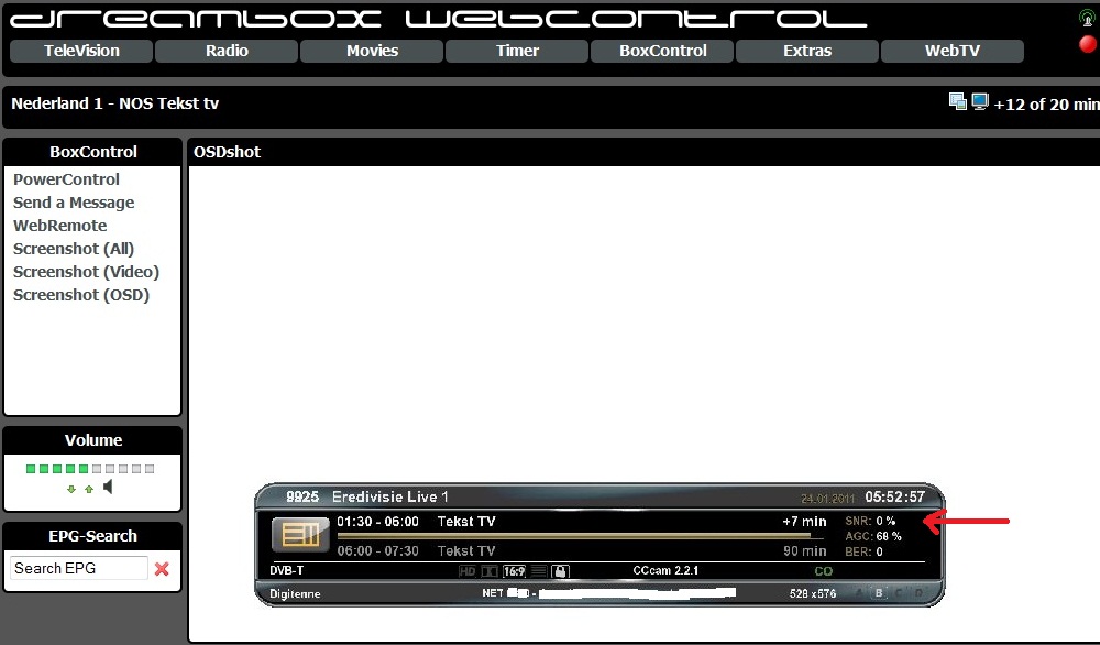

      Now i just have scanned the DVB-T channels, and see the channels give 0% SNR in the infobar, but AGC is working correct. (See screenshot)
      The rest seems to work fine, just that i see the "turning wheels" blinking the first second i switch a channel. (have a feeling it has something to do with the EPG?)
      Anyway, hope this info helps someone that is planning the same. 8)

    • Originally posted by neo_atomic
      It is necessary because the "-r4" driver included in newnigma feed hasn't the correct dependencies as the "-r55" sifteam one has.
      However i noted that the installed packs are "R4", and when i look at the Sifteam feed i see "R55".
      addons.enigma2.sifteam.eu/drea…e/dm500hd/Packages.stamps
      As said before, it would be useful to update newnigma feed to the newer driver versions...how much time it need?

    • Original von neo_atomic
      Those are the versions right.? (my Linux knowledge is very limited) is there a possibility to update your feed to those newer versions.?
      Thanks to you I solved, I used your telnet command, thanks again
