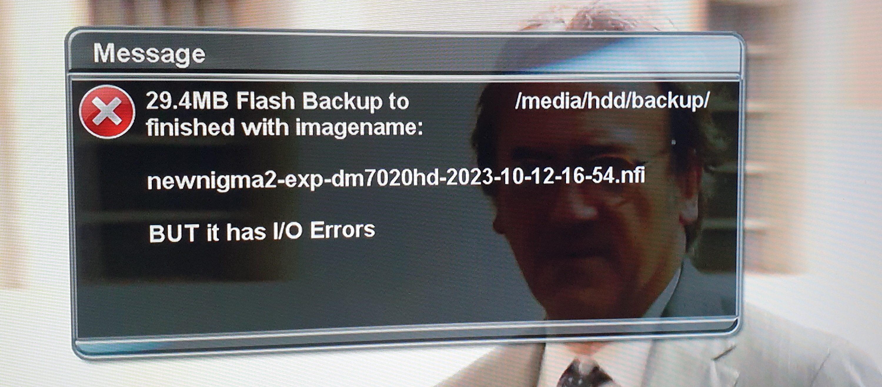

    • I am having problems backing up my 7020HD. I uninstalled dflash and did a fresh install but I am still getting the error in the attachment. My Backup image should be larger than 100MB..
      Any help appreciated.
      Thanks.

    • I/O-errors most likely show that your HDD has a problem. I suggest you try a different HDD before any more trials with software.
    • Thanks for your suggestion but seems that it is not solving the issue.
      Yesterday, I initialized my USB drive from image menu and recorder a broadcast to test it. It worked fine but when backing up the image it is showing the same error.
      DM800se
      DM7020HD
      DM8000HD
    • maybe the log-file of dflash would tell you what is the real problem.....
      And: I did search a little bit; looks like the I/O-Error will also be shown if you try to backup a corrupt file system, see here.
      so: check the dbackup.log, maybe it tells you that a specific file has a problem. If not, probably the only solution is using an old backup or flash a clean new image. :(
